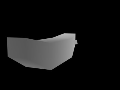

Hi
Why Z depth operation figure is the opposite? (Black and white)
Objects near the camera
Correct should be white
The more black later
How to set?
Posts: 10606
Hi LIANN YEE,
I guess that what is confounding you is that the Environment is treated in black. If enable Alpha channel and place the pass over a white color, everything should be more clear. About Z-depth, please, have a look at this video by Ahmet on this argument, it’s about c4doctane and AE, but the general concepts are the same:

thanks
