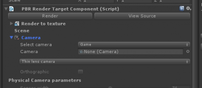

There is a slection box in the PBR Render Target for which camera to follow. Did you set that to Game Camera?

In addition to what Xhed says, and just in case that didn't fix your problem, be aware that, for some reason, sometimes the camera being rendered may change unexpectedly from GameMode to RenderTarget without manual intervention. It happened to me a few times until I realized what was going on. You might need to place your animation visible in the RenderTarget camera. I think GameMode is experimental for now.
