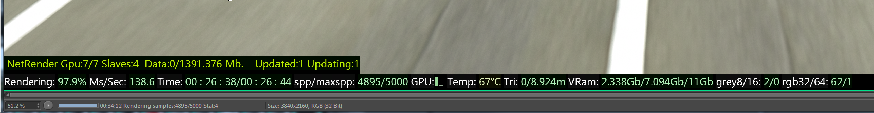

During this test, none of the slaves even reported an error of any kind. And you can see, Octane estimates it is 6 seconds from finishing the frame, but the C4D clock is 8 minutes over that. As soon as I unticked Network Render the frame finished.
It's not a memory problem either, it's using under 3Gb for the scene and the smallest card has 6Gb.
