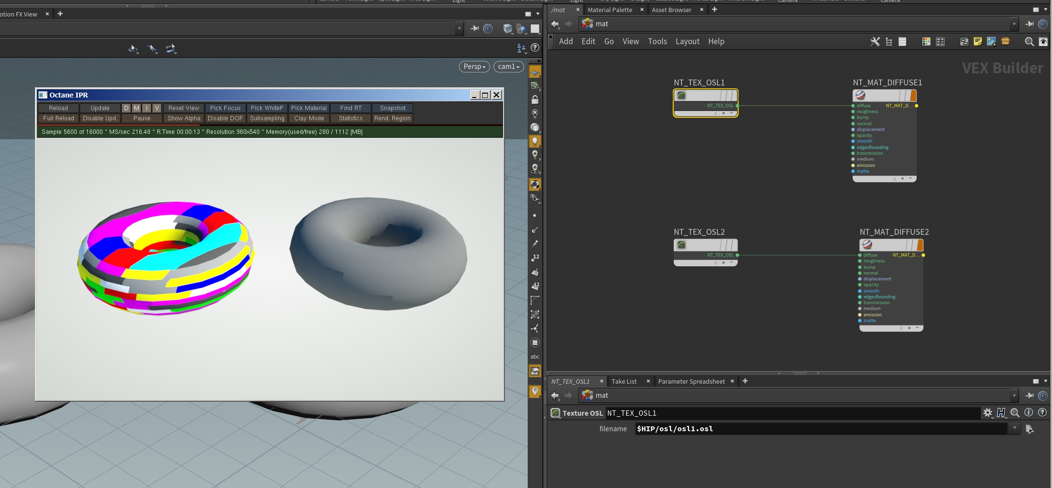

Posts: 8867
Location: Spain
Well, the OSL nodes should work, as you can see in the attached image. The problem is that without GUI in the VOP nodes for the OSL texture parameters, the feature is more experimental than useful in production. I hope to fix this limitation ASAP.

gui2one wrote:I meant a boilerplate for the osl code.
Could you perhaps post the os file you are using in the example you posted, to give a starting point.
This is a very basic osl texture that should work without problems.
Thanks,
-Juanjo
osl1.rar
(654 Bytes) Downloaded 373 times
Thanks,
-Juanjo
Thanks, at first I thought it didn't work, but I had to destroy and recreate a node and then loaded the osl texture.
Any other way to reload ?
Windows 10 |NVIDIA RTX TITAN - 24GB| i9-9900K | 64GB RAM
juanjgon
Posts: 8867
Location: Spain
The final version of the OSL VOP nodes are going to reload the osl texture automatically when you set a new file, at the same time that the plugin builds the parameters GUI and add the input pins in the VOP node. The current OSL VOPs are only an experimental feature and, as you can see, too limited.
