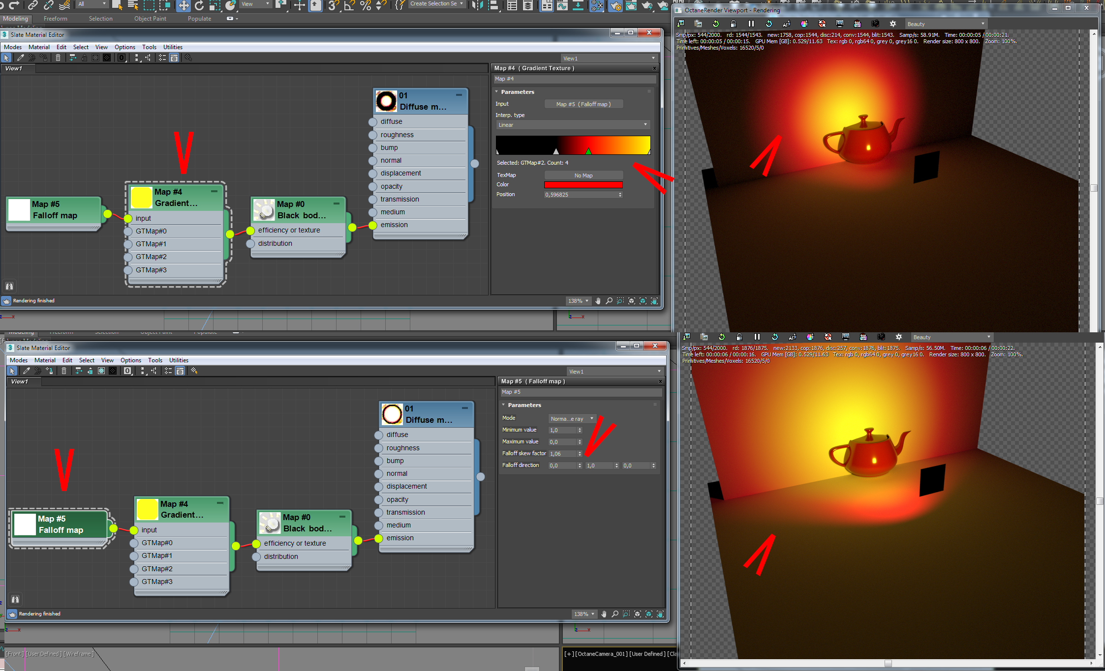

Hi DartFrog,
you could use this solution, without using IES, customizable and noise free.
Regards
Paride
Regards
Paride

Also, would you be able to post the settings you used in the falloff, gradient texture, black body, and material? I'm attempting this in a scene and I can't quite get this working. Thank you!paride4331 wrote:Hi DartFrog,
