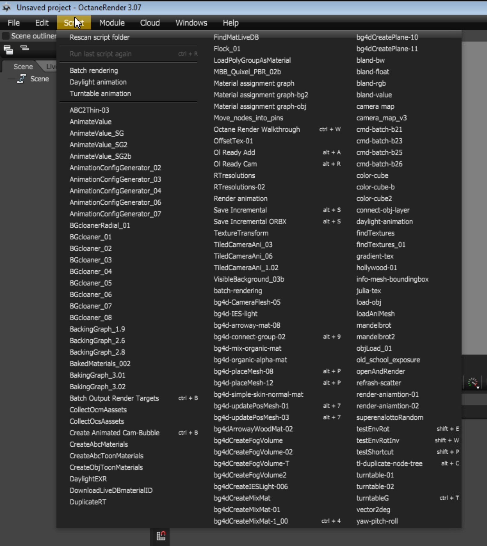

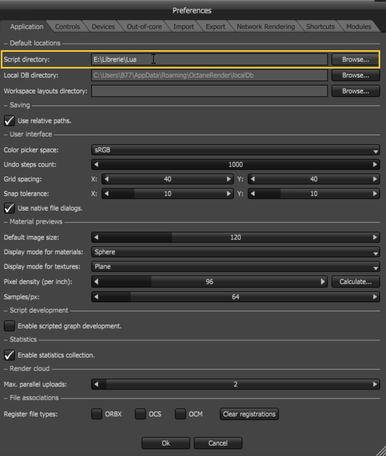

you need to define a directory for your Lua scripts in Preferences/Application:
Then, after rescan or restart, you will find your scripts in the Script menu, ready to be used:
At the following links you can find the documentation, and the list of the available scripts:
The Script Menu and Lua
Lua script repository
ciao beppe
