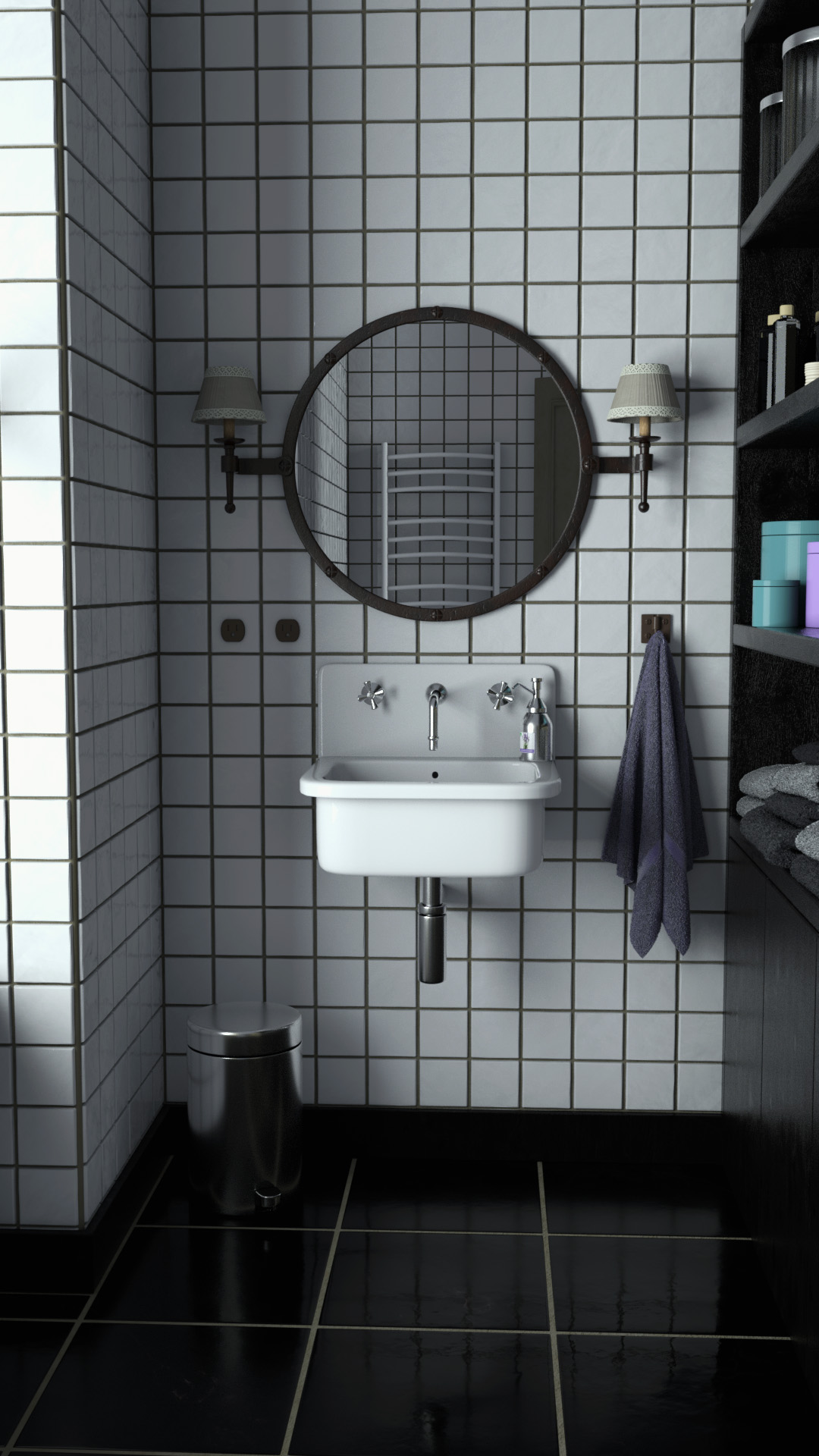

Here is my first arch attempt (from a web photo)
Made with Blender and Octane4Blender, Subtance Designer
Hope you'll like
C&C welcome

I think this is great. The lighting looks real. how did you achieve this overall colour and how did you do the tiles?. Im having problems.

Hi Dave
For the lightning, it s a simple plane with a blackbody emission. A bit of photoshop tweak to enhance the mood.
The tiles have been made from a simple flattened cube (in array). After applying the array, i ve just slighlty randomized the vertex.
and for the diffuse/normal maps, i ve used Substance designer
cheers
