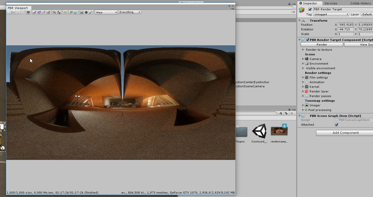

Awesome, thanks for the response. I've switched to Spherical instead but now the actual render itself appears grainy. Any advice on this? I've attached a screenshot b/c the render itself is too large to upload.
Xhed
Posts: 239
Joined: Wed Jul 10, 2013 10:27 pm
Location: Breda, The Netherlands
The grainy noise is a side effect of the path tracing being used by Octane. Setting your kernel up with a higher max sample target will reduce the noise.
