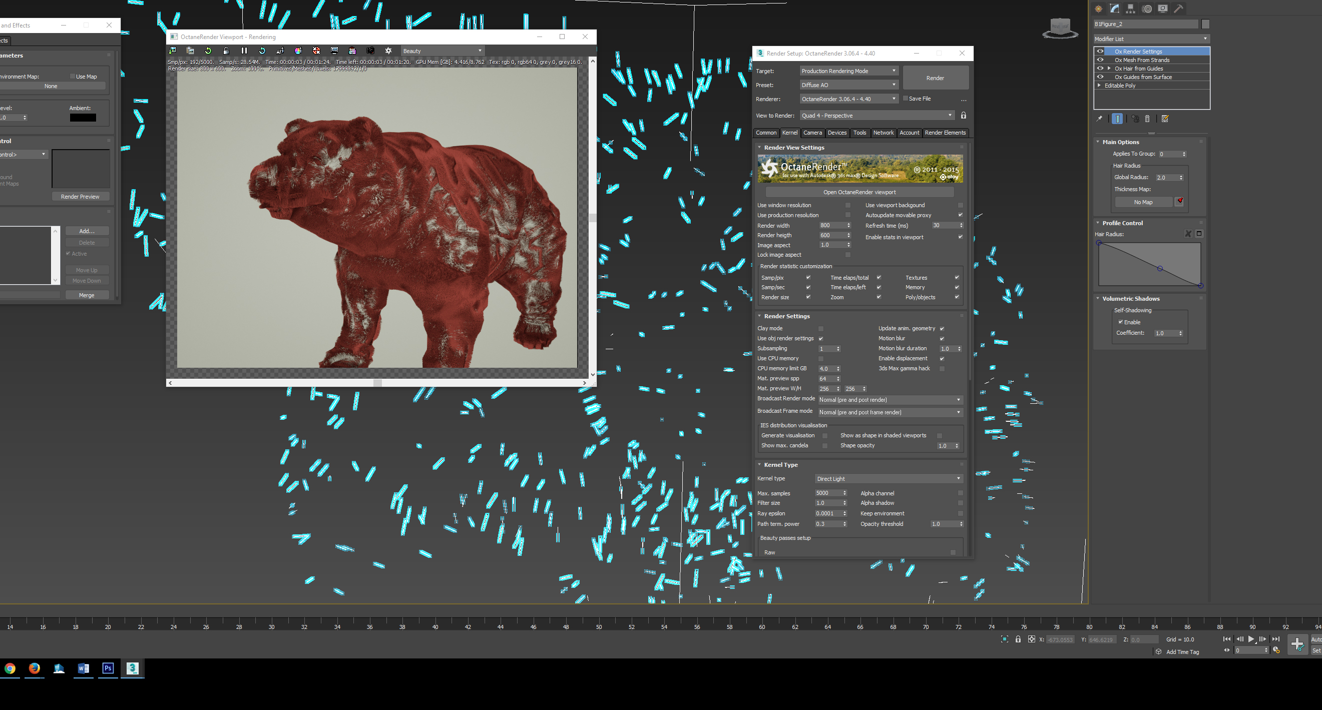

hi anyway to instance hair using ornatrix. we created 1mil hairs and it is 4.4 gb of vram
Also are there any special textures i need to use or just glossy texture?

you could use gradient node texture with W coordinate.

I'm not an Ornatrix expert user, did you use splines for your hair?
my scene has about 1.2GB
Regards
Paride
Thank you
I think cause I added a modifier ox turn to mesh
