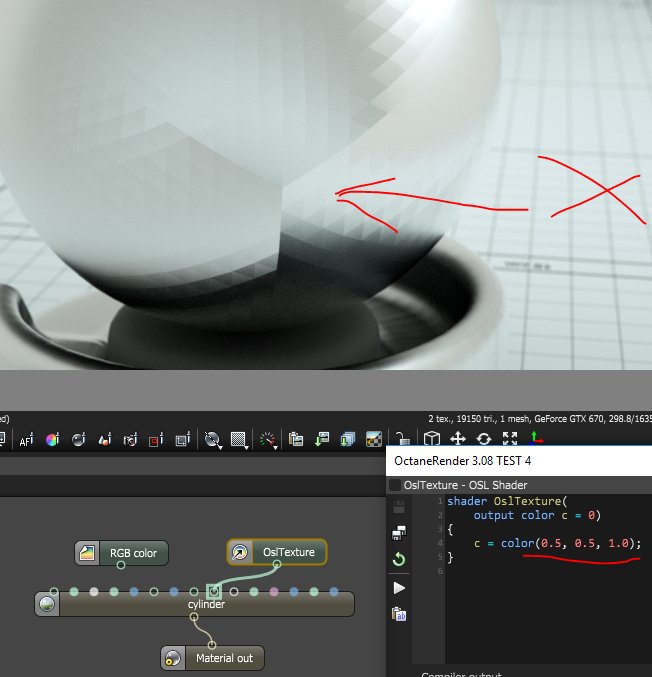

OTOY devs, there is some kind of colorspace problem with OSL shaders plugged into the normal pin on materials.
If you just output color(0.5, 0.5, 1.0) from your OSL texture, and plug it into a normal pin, the normals are incorrect (eg you will see triangle artifacts on the octane material preview ball). I have to add 2 color correction nodes after it with gamma = 2.2, to get the correct output
I noticed this while playing around with the vray flakes shader. It has an option called "flake normal orientation", which when set to 1, basically outputs color(0.5, 0.5, 1.0)
Regular RGB node to normal pin
OSL RGB to normal pin

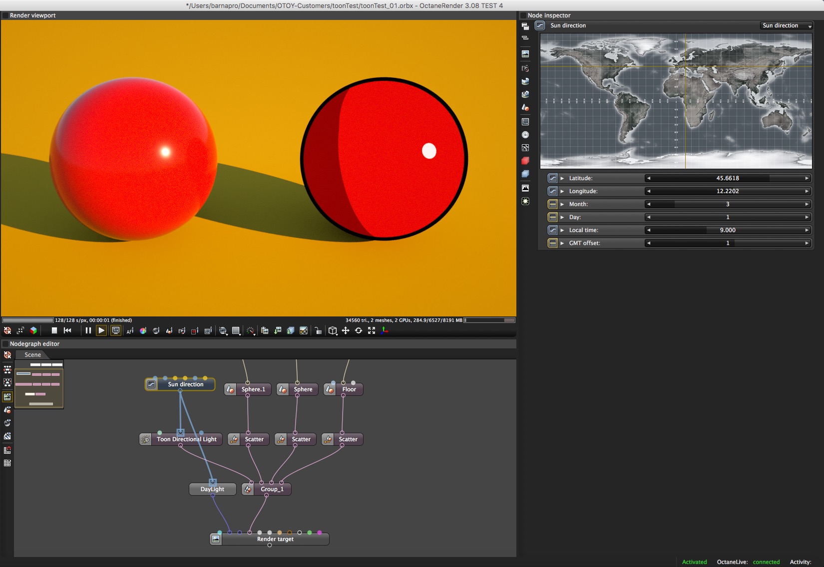

Please, have a looka t the attached scene with a simple setup to have the Daylight Sun position linked with a Toon Distant Light position:

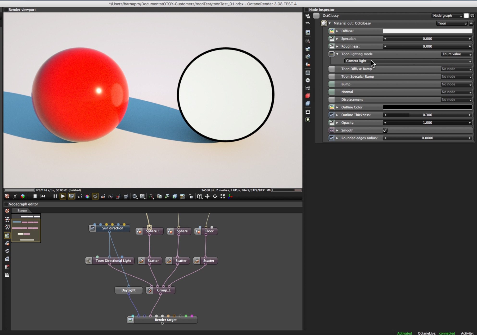

cool, I did find the toon shader, but next I wanted to do just the outlines - so it looks like some sort of technical render, just the lights.. and it always looks like it's trying to do the glossy shade of that outline color.. even though specular and all is at 0.. tried ramps, same thing .. like all toons are glossy.. should be an option to turn all of that glossy outline color off
- basically, black outlines on white, if it's not yet implemented, consider that - so we can get a technical illustration out, that would be awesome
Posts: 10648
Hi acc24ex,
you can set the specular at 0, and switch the Toon Light mode to Camera light:
ciao beppe

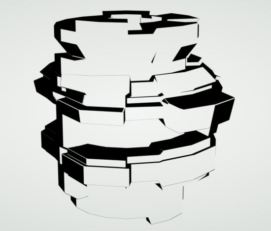

try doing a toon on this to get an outline only.. do the toon light affect this
Cylinder18 scifi 13 02 17.OBJ
(911.56 KiB) Downloaded 267 times
Posts: 10648
Hi acc24ex,
you need to play with the Outline Thickness value, but the issue comes with flat surfaces, not with curved surfaces:

thanks for the tryout.. so at low angles you get this "shine" overlay that is outline color/thickness.. check the boots on you characters at the bottom.. this is prononuced on this cylinder..
- octane guys, how about it - it will be very useful for archvis and product when you need to do a lineart type render.. tried all settings on the shader couldn't much closer than this
