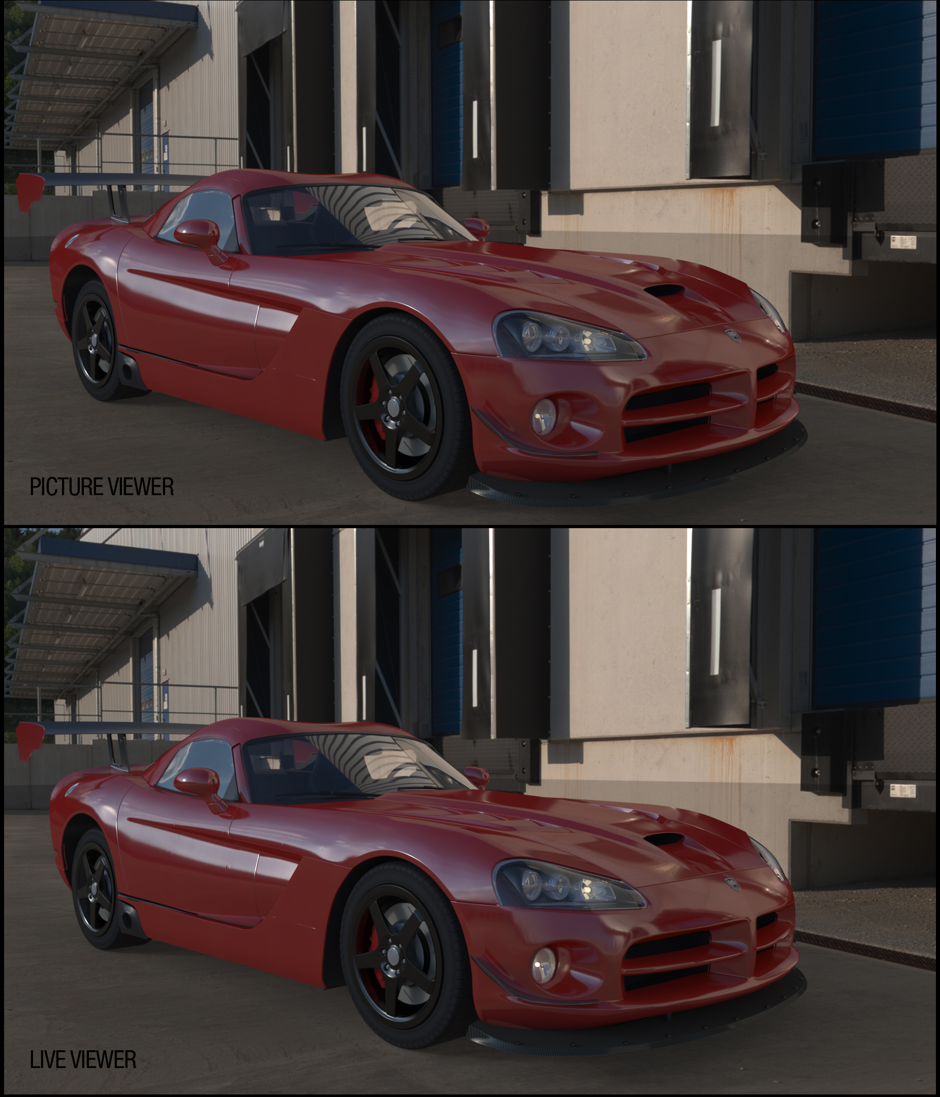

Trying to do a realistic render of a car, with a stock mesh. I've used an HDR, and created the shaders myself. In an attempt to make things a little less perfect, I tried adding some surface imperfections by way of a bump map.
The weird thing is, they only appear in the Live view, they don't show up in the picture viewer (attached jpeg) You can see the little dings on the door in the live viewer, not in the picture viewer version.
I've googled, read the FAQ, and searched the forum, but can't find this problem. Anyone any ideas?

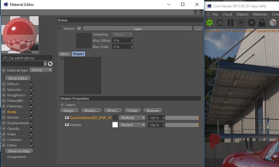

What's texture type in bump and version of plugin?

Hi, it's version 3.06.
The texture type is a layer with a marble, and a bitmap - I've attached an screen grab.

Using Layer or C4D textures is not an ideal usage for Octane.
Also same for XBitmap vs. ImageTexture. Go with ImageTexture type rather than C4D Bitmap.
