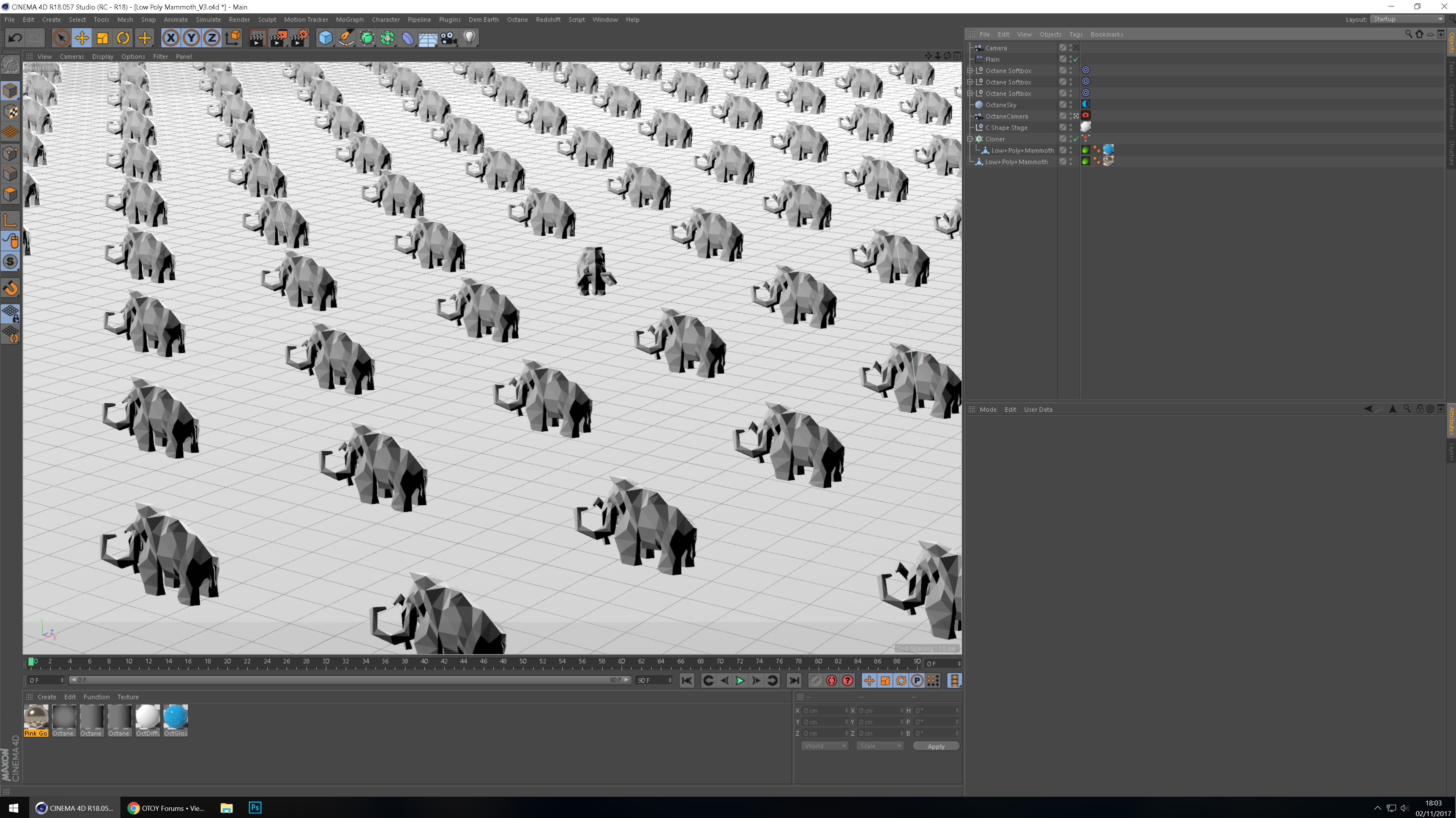

I am using an Octane Sky in the scene (and previous iterations) - I've attached a snap of it in case that helps clarifies anything.

I should quickly add - even though in the snap I am using a native cloner, I was using the Octane Scatter tag before. I was just testing this time to see if it was the Scatter tag that was causing the issue...
Posts: 10626
Hi Claire,
maybe is related to the Softbox objects.
Please, try to remove them, to see if you have more stability.
Thanks,
ciao beppe
ClaireSel
Posts: 4
Joined: Mon Nov 28, 2016 6:10 pm
Hi Beppe,
Thanks so much - that actually does seem to have helped! How did you know?!
Thank you again
