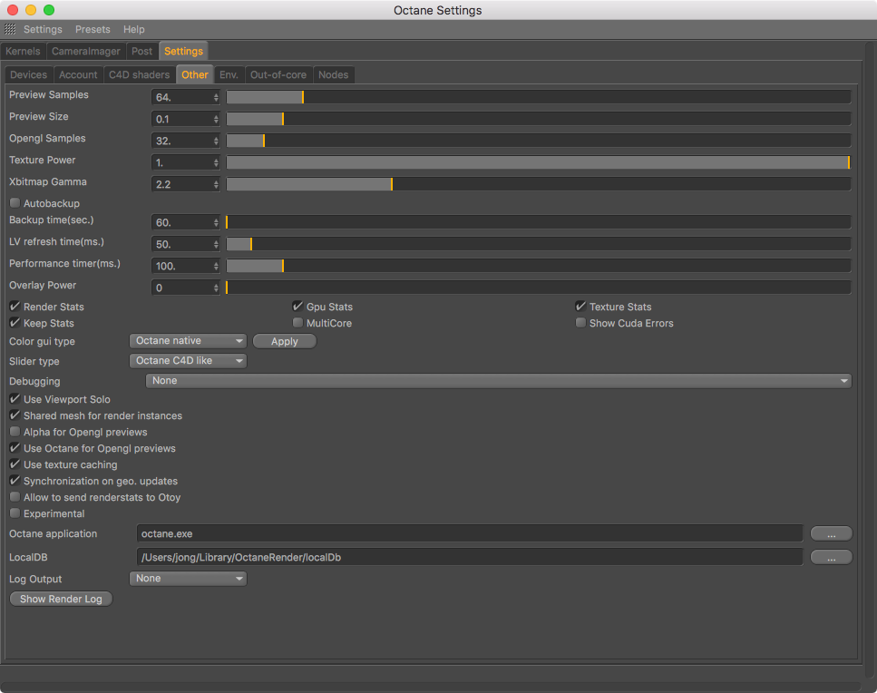

I've attached the screen shot of the settings.
Thanks!
Posts: 16068
Location: Türkiye
What's happening if you try with these?
- Navigate with keys not icons from top of screen?
- Different value of "Synchronisation on geo. updates" from settings->others.

It seems that unchecking the "Synchronization on geo. updates" worked so far.
YAY
