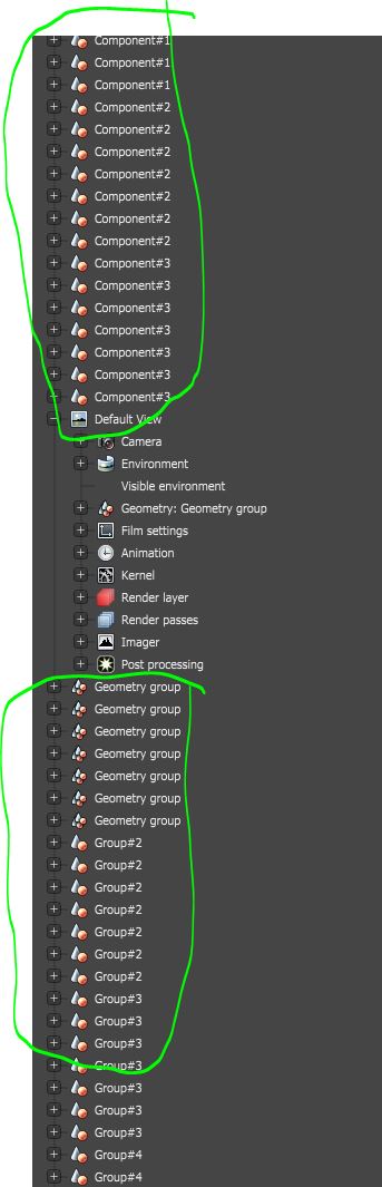

it might just be me, but i find all the component and geometry groups and groups a bit disturbing - could they somehow be grouped or is there a deeper meaning as it is now?
jorgensen
HOME octane standalone v3.07 | octane plugin for sketchup 3.07.0.14 | sketchup pro 2017 17.2.2555 64 bit | windows 10 pro 10.015063 build 15063 | i7-6700k @4.0 GHz | 32gb ram | 2x gtx 1070 | nvidia driver 382.33

Jorgensen wrote:it might just be me, but i find all the component and geometry groups and groups a bit disturbing - could they somehow be grouped or is there a deeper meaning as it is now?
jorgensen
Octane makes a lot of unnecessary nodes. This seems to crash Sketchup when using proxies. I can use proxies, but has to remove it and delete the nodes to the right of "Default View" (se picture).
Then its ok to save/open new file etc.
jorgensen
This is an artefact of implementation, because standalone was always intended to deal with the entire node graph, not a portion of it. This will be getting fixed soon.
