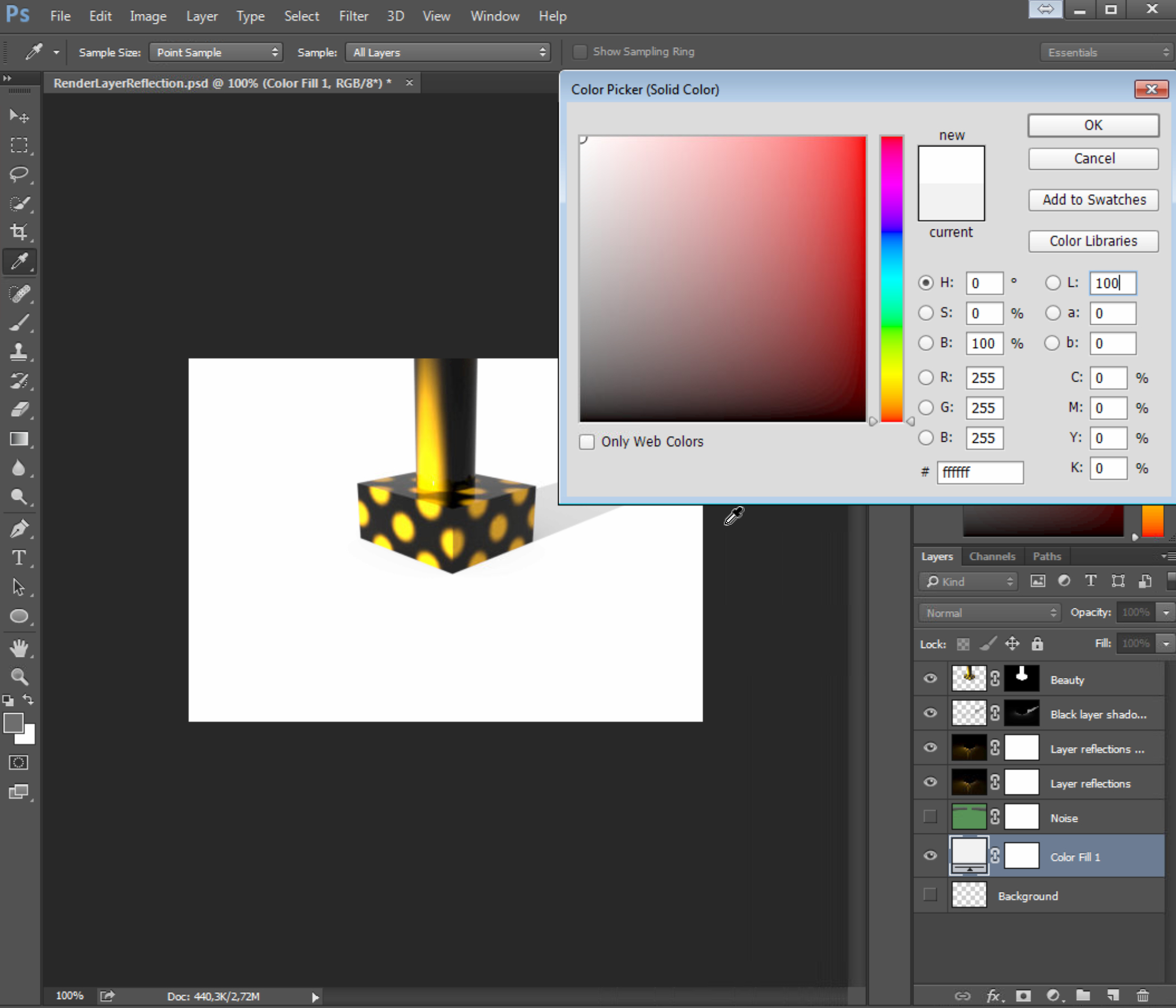

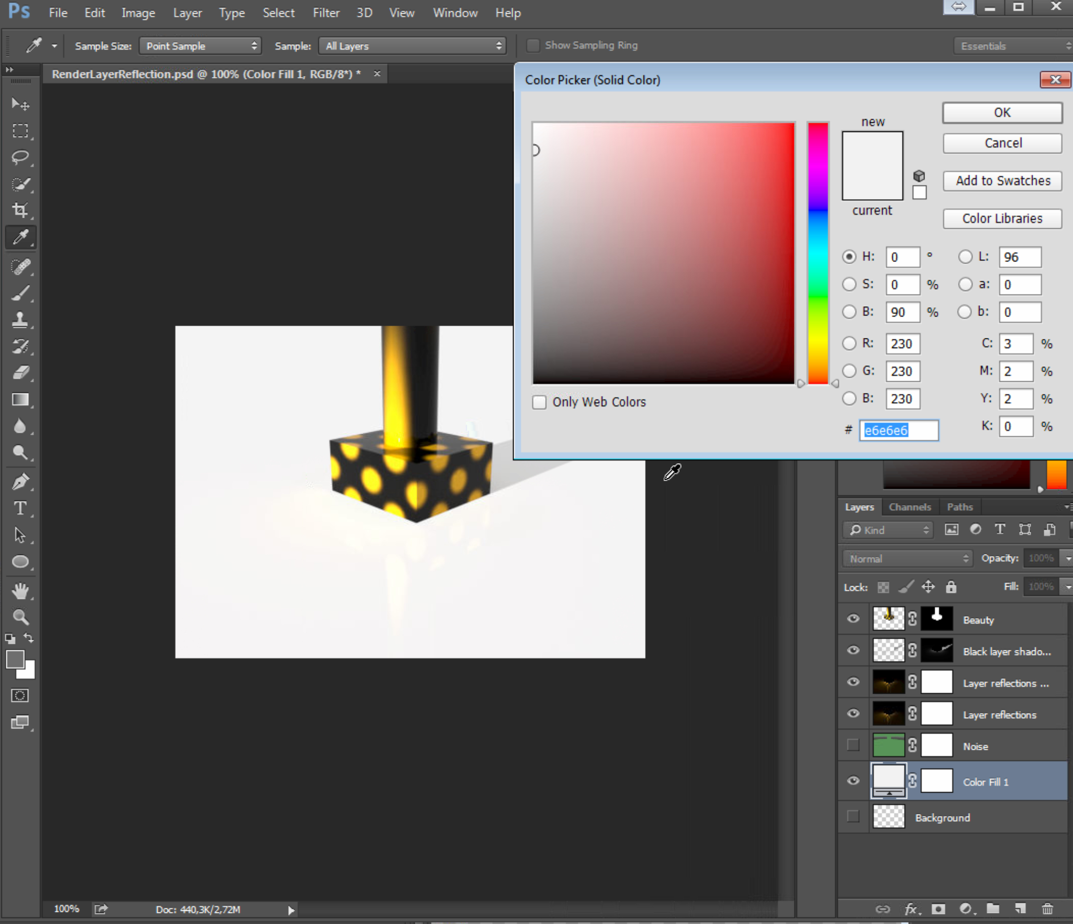

I'm sorry to re-open that post but I didn't really understand how it works.
I rendered the shadow and the reflection passes of my Render Layer but when I comp in photoshop I get a full white reflection (even with a slighly gray BG). It seems that I can not get back to the original look. You can see the picture attached, showing the live viewer render and the photoshop compositing side by side.
Thank you,
J.
Thank you,
J.
what happen if you change the fusion from Screen to Add in PS?
ciao Beppe
ciao Beppe
- jeremyshin
- Posts: 106
- Joined: Thu May 04, 2017 5:59 pm
please try with 2020.2-RC6, Linear Add 50% seems to work correctly here: ciao Beppe
