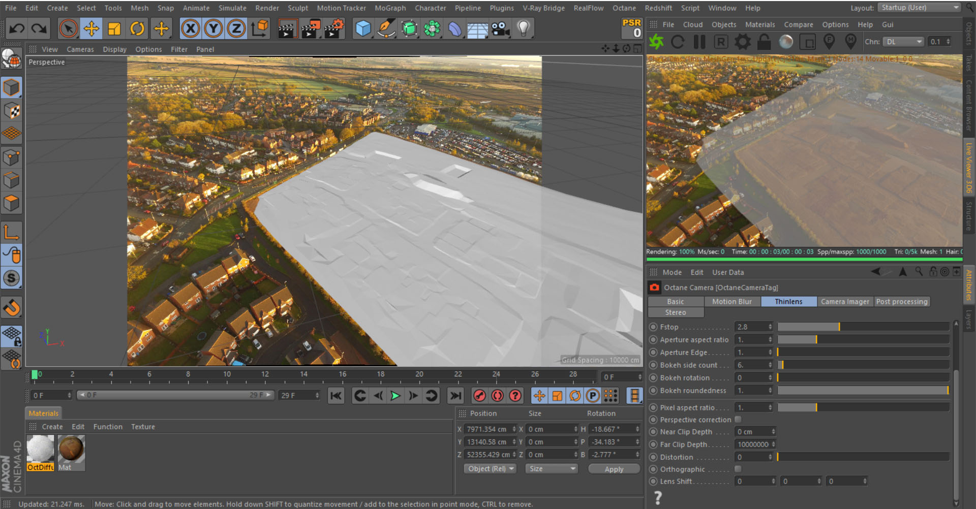

Hi guys, am having an issue whereby i'm bringing in an alembic file with a camera, a mesh and setting up a background object to show a drone photo, but whilst the viewport shows them aligned, the mesh is shifted within the LV and PV.
Any thoughts on why this would be?

Have you tried to use LOCKRES button in LV?

Hi, yes, have tried that and makes no difference. Have just updated all to V3.07-R2 to see if that made a difference but it doesn't.
