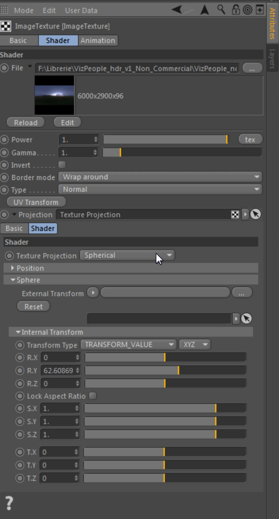

Hi guys,
about the Environment rotation issues, in the meantime, enter in the Imagetexture node, create a Projection node in Spherical mode, and change the rotation values:

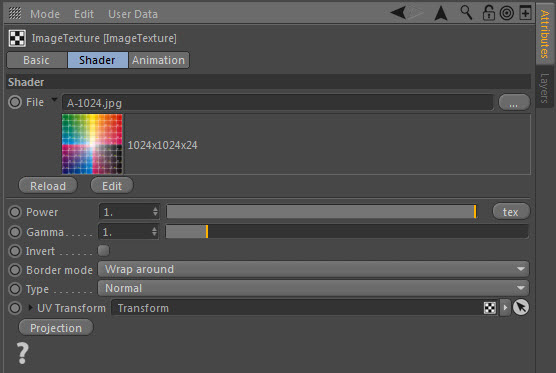

Add a default transform to imagetexture and it will work as i can see. I'm looking for a fix.
