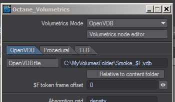

juanjgon
Posts: 8867
Location: Spain
You don't need to rename anything. You only need to set the $F token in the "Open VDB File" parameter, as you can see in the attached image.
Thanks,
-Juanjo
drako3d
Posts: 19
Joined: Fri Mar 22, 2013 1:23 pm
Juan you have make my day.You are my God....
Thanks a lot.
