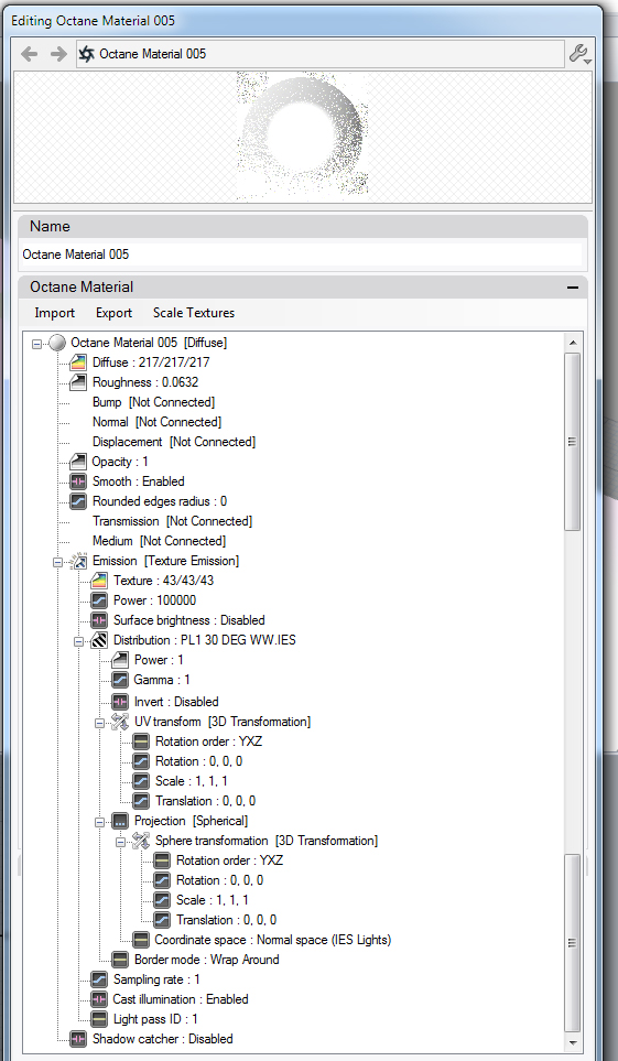

paride4331
Posts: 3985
Hi alfabruce,
I'm not a Rhino workflow expert, but I think about it like this.
Regards
Paride

HI Paride,
Thanks for posting that. Ive followed the material specs down to try to create my own.
how did you input the PL1 30 deg ww.ies info into the distribution part. Is that something you found somewhere.
Im really just trying to make some simple spot lights and direct lights but dont know where to start.
It is a Greyscale Image.

Thanks Paul. So I can make this image myself.
Cheers
Tim
face_off
Posts: 15809
Location: Adelaide, Australia
You cannot make this image yourself. You will need to download an IES file for the light you wish to replicate and load it into the Greyscale Image node.
