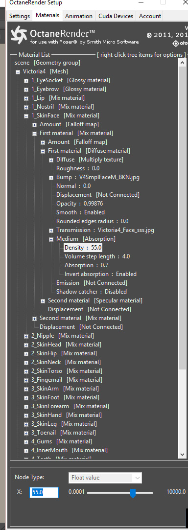

Easy to fix.. As you can see in the attached image of the Octane Materials settings, you would want to change the Density setting UP from 55.. I find that 555 will completely remove the red without taking away from the face.. I think what it does is make the skin less translucent.. (like the sun shining behind someone's ear)
This is the same setting that you would use for red hands and feet, glowing nipples etc.. Especially for when using RedSpecc skin shaders on darker skinned models etc.
Hope this helps.
