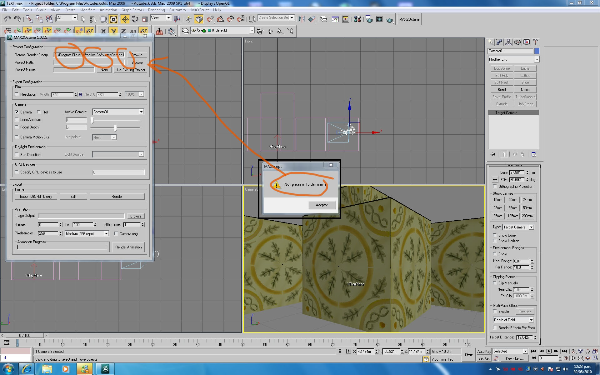

why appear this message ?
roco
Posts: 162
Joined: Mon Aug 30, 2010 1:12 am
Location: merida, yucatan
i'm try to understand why i see this leyend on my screen when i try to export a scene to octanrender, i bought the programa and i'm waiting for the activation code to licence and use full the program, can you help me ?
i add image generated when i pick in the option in project path
Uploaded with ImageShack.us
maybe will be becouse i don't have activated the product yet ?

You need to rename the directories in this path.

i did that but always is the same result in all scenes
that will be becouse i don't have teh activation code yet to the lincece ?

I only use the BLENDER exporter, but it seems to be the same issue here:
You mustn't have any spaces in your paths' names.
Here is the link to the thread:
http://www.refractivesoftware.com/forum ... 0&start=70
And one of enricocerica's replies to this problem:
You just can't have space in the project or image output path. This is also the case for the project name but the script automatically fix it by replacing the space by an underline character.
