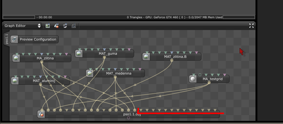

I have a scene comprised of some objects that can have multiple materials assigned to their mesh. Some materials are shared between multiple objects. When I export it, the .mtl file contains duplicate / redundant materials.
1.) Could someone check the attached .blend scene and verify this. In it there are 3 materials, but the exporters in my case (octane and obj exporter) write down 4 materials in the .mtl file.
2.) Is there a way in Octane to re-assign materials to different parts of the mesh - ie. replace the redundant material indexes with only one instance? Something like 'expanding' the mesh node to see the material nodes and their connections, and then re-assign them?
Also, it seems that the obj exporter writes down only the names of textures in the .mtl file, which is not very useful. Couldn't the Octane exporter write down absolute texture paths for existing texture channels (COL -> diffuse, SPEC -> specular, NOR -> bump...) assigned in Blender, and pass them to Octane? The exporter could still comply to the .obj specification in the .mtl, but write down additional data in the .ocs file.

I created material nodes and then attached them to all the duplicate material indexes. That did the trick, but it's messy.
Anyway, when I saved and reloaded, the mesh object contained new duplicates (this is from another project, not the zip above)

I had a look to the script and indeed when objects have multi materials assignment, the script creates as many definition in the mtl file as there are objects, duno why the obj exporter was made like that. I changed the script to only have one occurance of each material and it seems to work fine. I'm doing some tests and will release the script asap.
By the way the materials saved in the ocs files will be lost and should be redefined as the name will change.

The duplicate materials issue is solved and the new script is available, see the release note for details.
Regarding the absolute path, this should be a new option and would change the actual behavior of the script, we'll see later on if this could be added.
