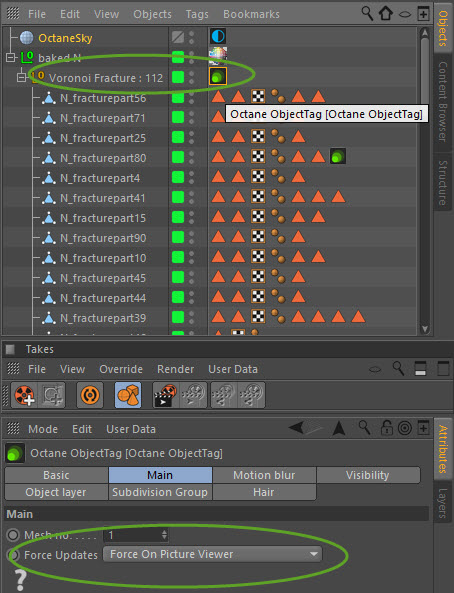

Yes sliding is expected behavior as Mesut said because of Cube mapping on top. Problem is that meshes not getting updates in Live Viewer due update detection mechanism in this case. To avoid lack of detection use a tag with marked option.

Thanks a lot, one question though, shouldnt the tag be "force updates to live viewer" instead of picture viewer in order to see the problem from the beginning?

thanulee wrote:Thanks a lot, one question though, shouldnt the tag be "force updates to live viewer" instead of picture viewer in order to see the problem from the beginning?
It was just for Picture viewer in previous versions. But i've changed to work on both if i could remember well.
