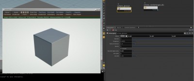

Hello,
The Octane materials Diffuse, Glossy and Specular all have a edgesRounding option, which I think requires a float node but I haven't seemed to get this to show up in my renders. Does anyone else have this problem? Any solution to this?
juanjgon
Posts: 8867
Location: Spain
The rounded edges feature works using the "Rounded edge radius" parameter, nothing else is needed. What problem do you have with it?
Thanks,
-Juanjo
