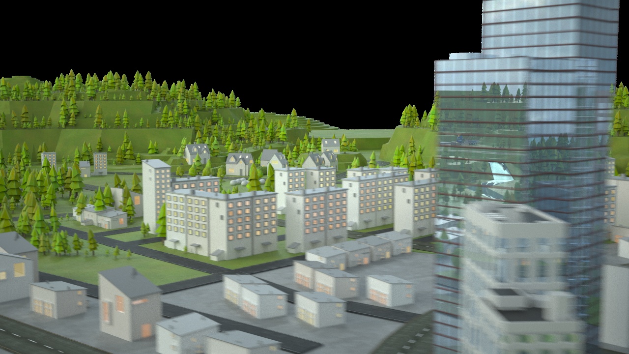

I was wondering what i need to do to get the reflection blur when using camera motion blur.
In this image i have simply just used camera motion blur, because the camera is the only thing moving.
But it looks a bit strange when the reflection from the building is all sharp while the rest is blured :)
Cheers
-Mats

reflections are sharp because the objects reflected are far away, so they "move" very slowly, the object in front of the camera is "moving" faster so it is blurry.

ah.... so it physical correct? its more an illusion :D
thanks for clearing that up mate.
