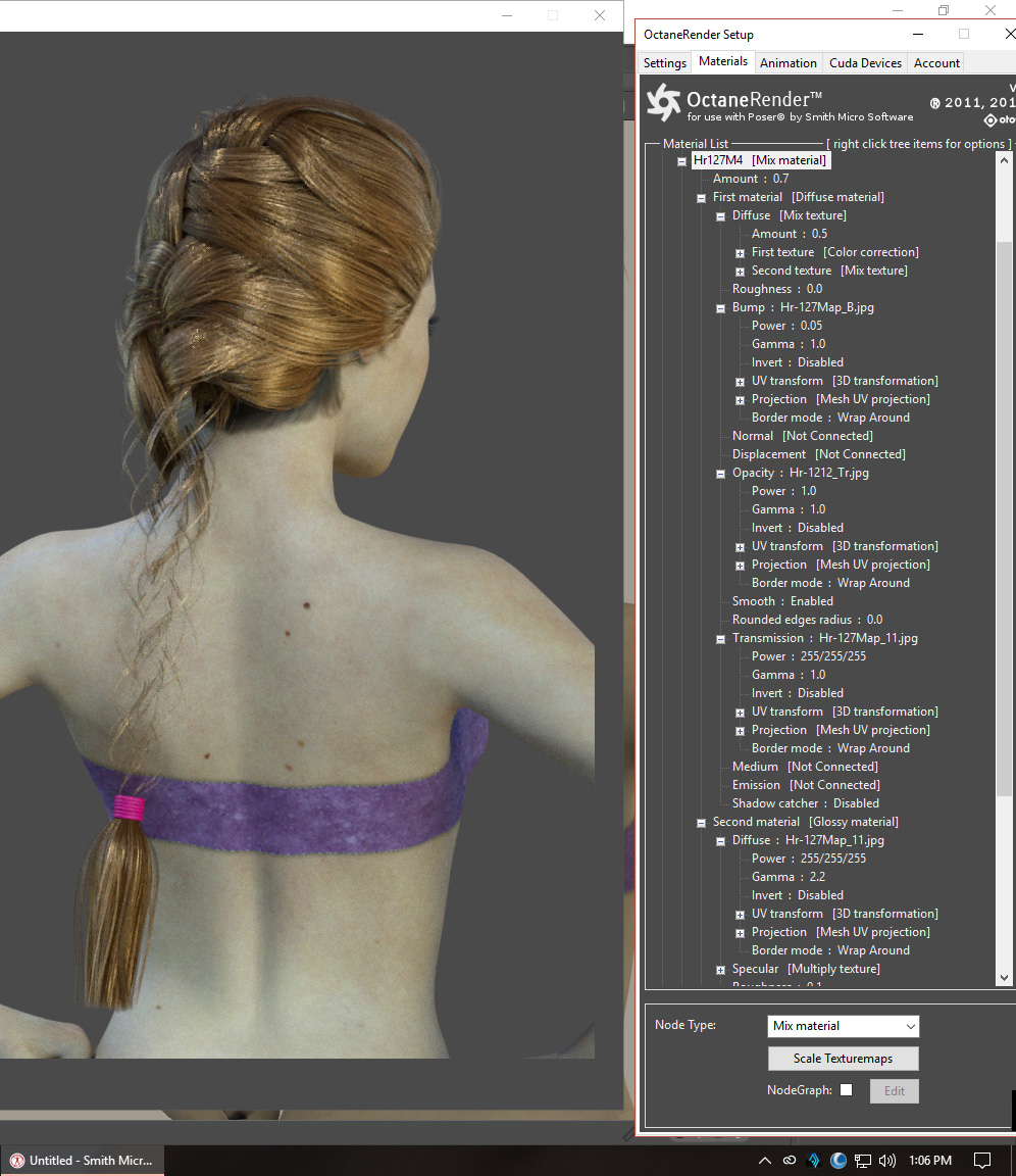

Greetings, I ran into an issue when using hairs with Braids.. This appears with Ali's hairs and other vendor hairs as well when using the wonderful redSpecc hair shaders on them.. The sample image shows what I mean.. I'm not sure why I never noticed this before..
Anyone have any ideas how to correct this? It renders fine without the redspecc shaders but not with.. =(
What makes it weirder still is that I managed to make it work just ONCE, the first time I ever used that particular hair with the redspecc shader and it will never ever work again.. I have to reload the same model sporting the hair and then change the body morph and skin shaders afterwards.. so odd so weird.. This has been a persistent problem even after a few Octane updates.. maybe one of the updates broke it?
Anyway, hoping someone's figured this one out..
thanks in advance.

Many thanks for that.. I wasn't able to figure out what you meant by going to the materials room to remove what ever it was causing the problem, however you did leave me enough clues to see that I most likely copy-pasted a bad node onto the M4 part (braid) and that was cached in permanently.. I got that removed and now all is good..
MANY thanks!!

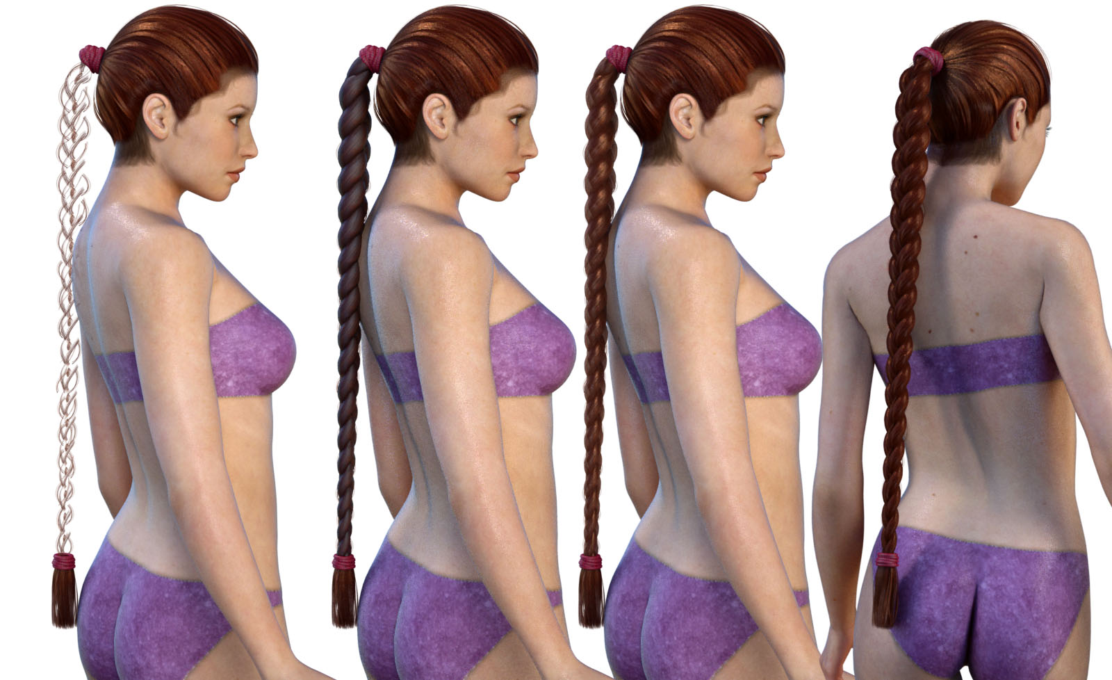

I'm still struggling with the "braids" part on anyone's hair as well but found some workable 'work arounds' for it..
The steps recommended by wimvdb are valid yet I don't see the nodes that he refers to in Poser to apply his fix so had to come up with something that would work for me..
I think this works 90% of the times I use braids so hopefully some of this might help you
There are two hair shaders by RedSpecc, I typically use the RedSpec_TGX_Hair_Poser one instead of the RedSpec_TGX_Hair_Poser_auto-displacement_beta file as I find that last one results in very detailed hair that takes much longer to render..
Attached image shows (LEFT) what I end up with the problem braid issue.. SO, to fix that, I reconvert material from Poser, and then apply the RedSpec_TGX_Hair_Poser_auto-displacement_beta file to ONLY the hair material that is causing the problem, in this case, 107M4.. but it leaves the hair not quite right up close.. you can see through too much of it still...
So in the end, I "Copy mix material node" from the head piece and then PASTE the mixed material node to the 107M4 using the copied imagemap.. and the braids on the far right image is what I end up with.. i think it looks right?
I would still like to know how to get this to work properly though.. I had recently purchased someone else's braided hair and it did the same thing, even though it was the first time seen on my system.. ?
Anyway, I do hope some of this helps.. ?
