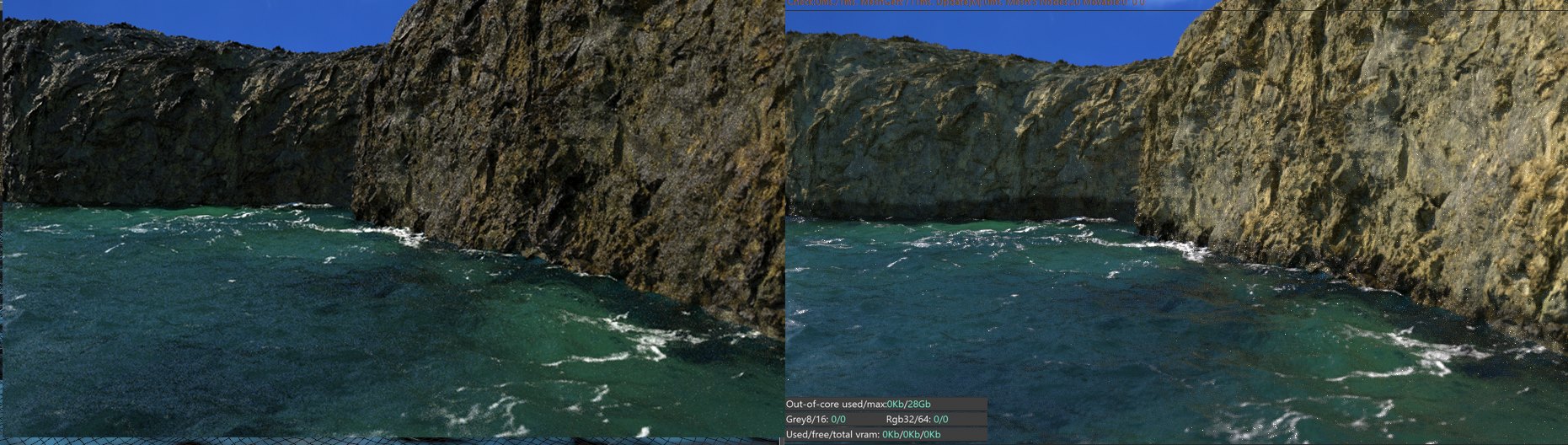

Please see attached image: on the right it shows the vertex map that determines where the rock looks wet, rendered in live viewer. On the left you can see the picture viewer where the whole rock is wet and the vertex map is being ignored.
Setup is: image texture for diffuse mixed with itself and color correction, amount is driven by the vertex map. For specular I mixed black and white RGB spectrums, amount again being driven by the vertex map.
Any ideas?
Left: Picture viewer / right: live viewer

how is geometry engine option?

It was on "Resend only updated objects". After changing it it now works. Thank you for the hint, stupid mistake on my side... :)

Can i get sample scene? I can add a detection for case to current option.
