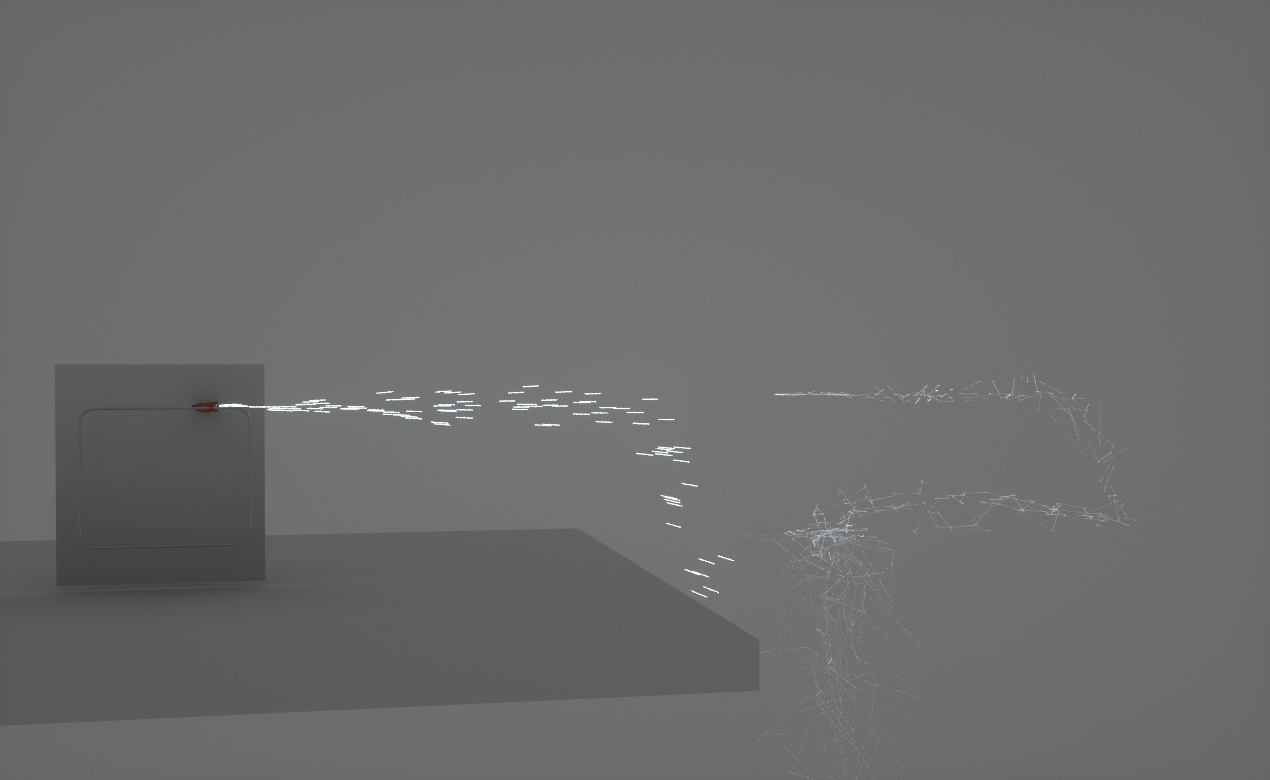

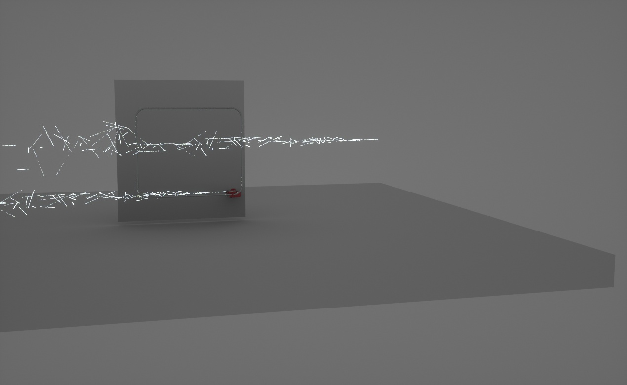

why do pflow sparks motion blur looks strange. I thought it was fixed
even using mesher does nothing like this old post said viewtopic.php?f=81&t=55639
and we do use DELETE event to kill off the particles
paride4331
Posts: 4001
Hi coilbook,
MB seems to work with mesher too. Maybe I'm wrong about your issue, could you share your test?
Regards
Paride
coilbook
Posts: 3176
paride4331 wrote:Hi coilbook,
Regards
Paride
HI Paride
here is the scene with wrong mb direction Thank you
it seems when saw moves horizontally sometimes it works sometimes it does not. Sometimes pflow works and mesher does not .
Also some frames it works and some frames it does not. Frame 371 it works and frame 372 it does not. Delete operator messes with pflow
