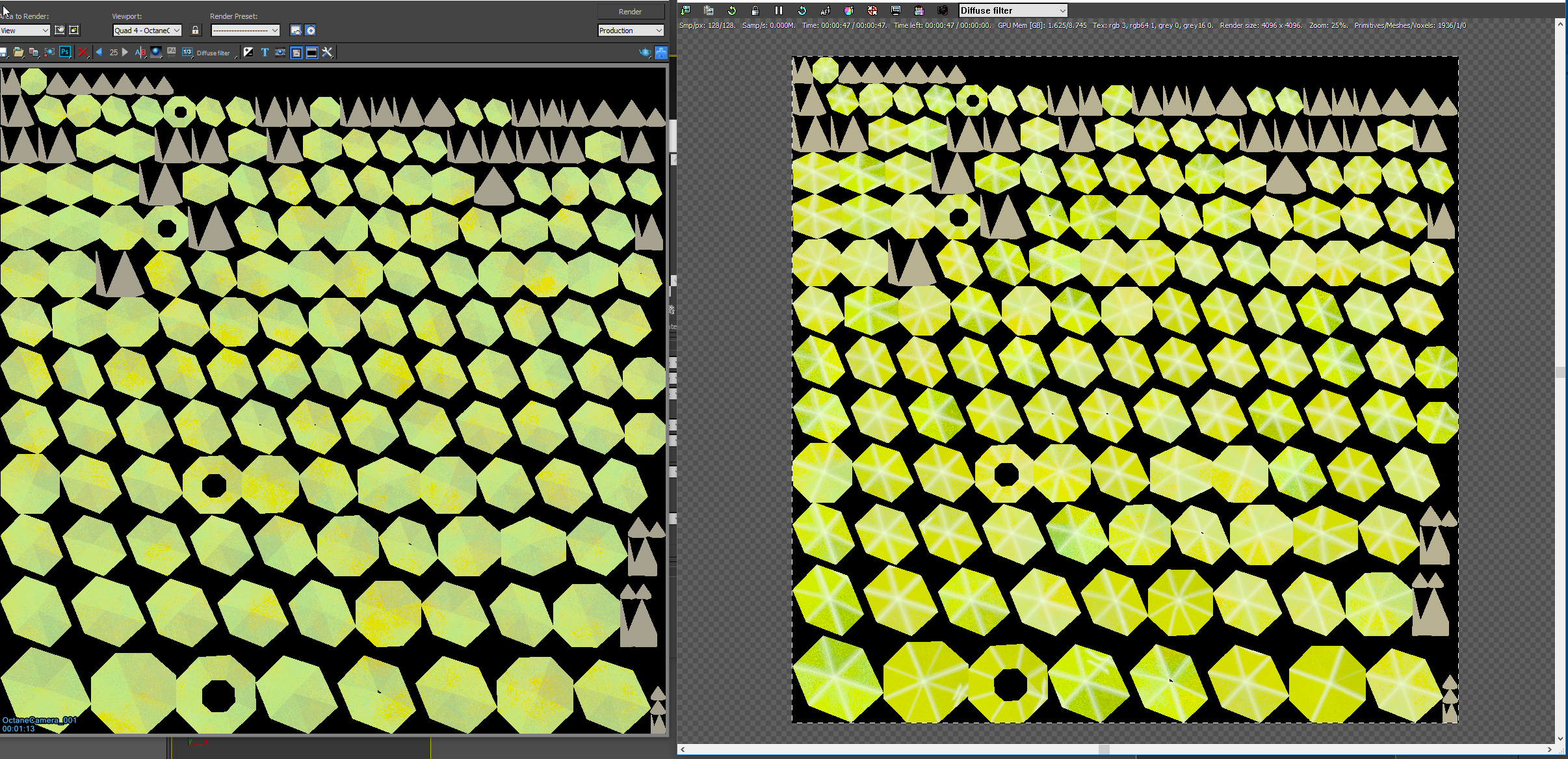

or might it be a bug?
Because i just realised the active render shows the diffuse filter with the dirt on the edges while the one rendered does not.

well guess who feels stupid now......
There is 2 different Diffuse filters....Info and beauty....... * sight *
Sorry for the trouble!
