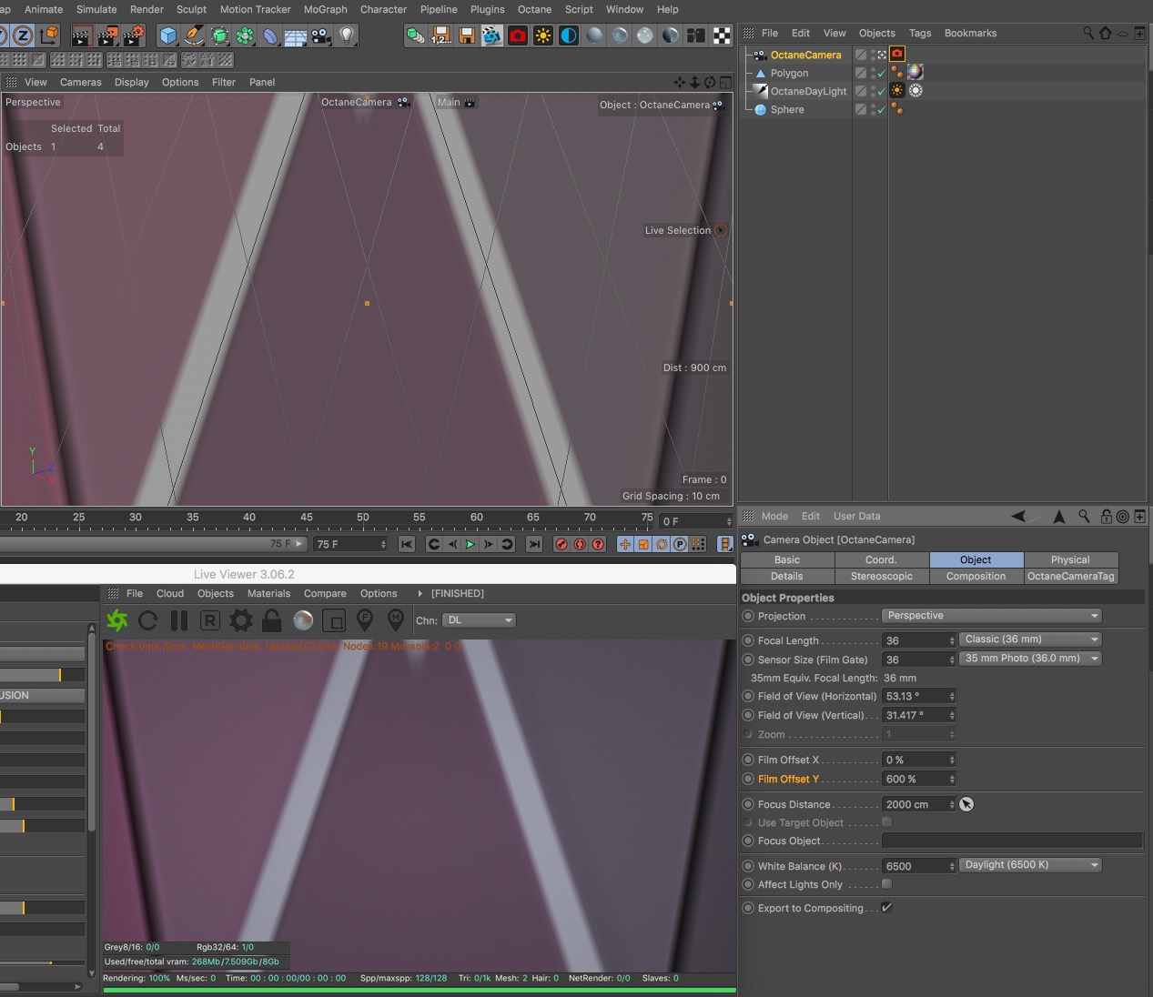

I have tried to reproduce the shift lens issue but here is working as expected at 600%:

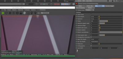

And the Lens shift value in the Octane Camera node works in meters, so you need to enter -6 in the Y axe:
