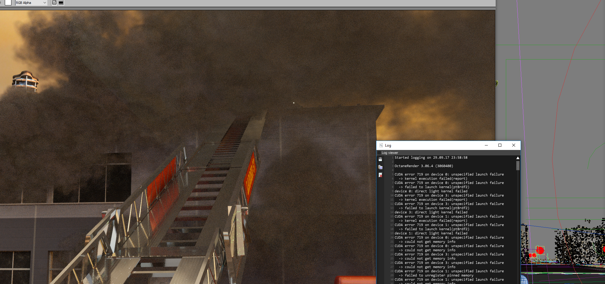

it seems i get instant crash when i render with 2 phoenix volumes. When one is hidden it renders fine. And I am only using 5.5 GB out of 8 of vram with 2 volumes. Octane just does not like two volumes in the scene for some reason. Also changing camera angle a bit like pointing at the side of the warehouse with flames on opposites side produces more stable results. it's like there is a problem with overlapping grids.
Thank you
UPDATE:
it still crashes at any angle. Master, slaves both windows 7 and windows 10 different drivers version. Most other scenes work fine. So it is octane bug related to kernel and multiple VDBs maybe
UPDATE:
It looks like it is more stable when we render at 1500 samples. At 3000 we get 719 error after windows tells us 3ds max was blocked from accessing graphics hardware (before we added windows delay in registry we had nvidia stopped working message ). We have other scenes we rendered at 10000 samples and they render fine so it is not heat issues.
CUDA error 719 on device 1: unspecified launch failure
CUDA error 719 on device 3: unspecified launch failure
CUDA error 719 on device 0: unspecified launch failure
-> kernel execution failed(report)
-> failed to copy memory from device.
-> failed to launch kernel(ptBrdf2)
device 1: direct light kernel failed
device 3: direct light kernel failed
device 0: direct light kernel failed
could not request a tonemap because we don't have any renderthreads available.
-> could not get memory info
UPDATE:

seems like more smoke present worse it is like this scene crashes with 719 error right after it starts rendering
UPDATE: It seems that hiding the skyscrapers behind the smoke fixes the problem. Not sure if smoe and reflective skyscrapers do this
I will try if i can get all the stuff switched to win 7
