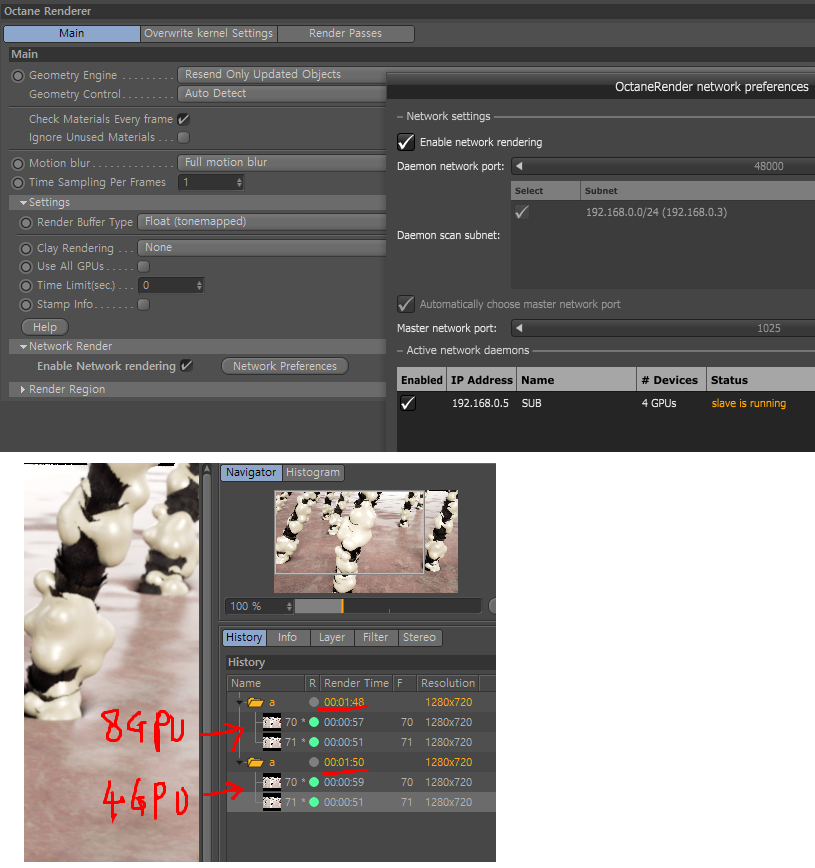

I have 2 PC(4ways PC + 4ways PC).
It takes 51 seconds for network rendering connections. But it takes 51 seconds to disconnect.
Can you tell me why?
PC1, 1080 ti 4ways, 16Ram
PC2, 1080 ti 4ways, 8Ram
(this file : 75mb)

which kind of connection you have between Master and Slave?
The dimension of the scene is different from the c4d scene size, you should see the amount in the upper line of the info text in PV.
With Gigabit ethernet connection, 75mb should be instantly sent.
