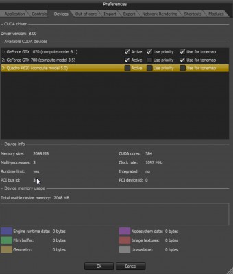

If you write only one number, you end up to render only with the GPU in the specific bus id.
You need to specity all the PCI bus id numbers of the active GPUs.
So firstly you need to open Standalone and discover the PCI bus id number of the GPU that you want to disable, in this example PCI bus id 3:
Then you need to write --gpu "1,2" to disable the GPU in PCI bus id 3.

damn im i idiot..im sorry, i didn't know that :-)
thx for ur fast help.
