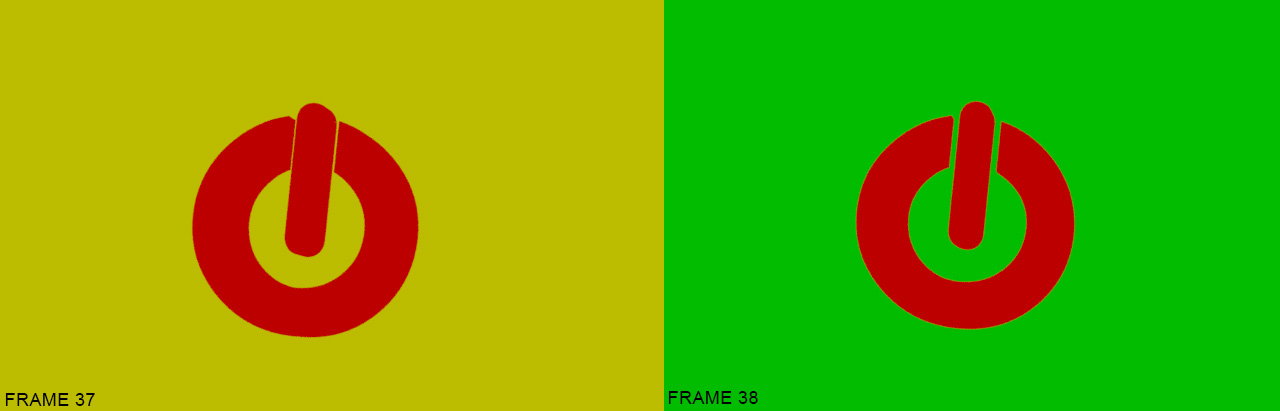

When provided scene is rendered here is change I get in frames 37 and 38:
So obj id changes colour from frame 38, and those colors should be consistent through whole sequence.
I just narrowed the reason, it happends when object is "eaten" completely by another object (Boole operation A without B)
Also noticed that if I remove displacement from material of that object problem disappears and colors on object ID are consistent.
Posts: 16068
Location: Türkiye
There's not any bugs, that's logic of how numbering works on ObjectID. They are produced by order of appearance to octane geometry structure. Here some objects are disappearing at frame 38/39 so automatised color assign is changing. You should use Render Layer ID pass from Info passes not objectID pass.

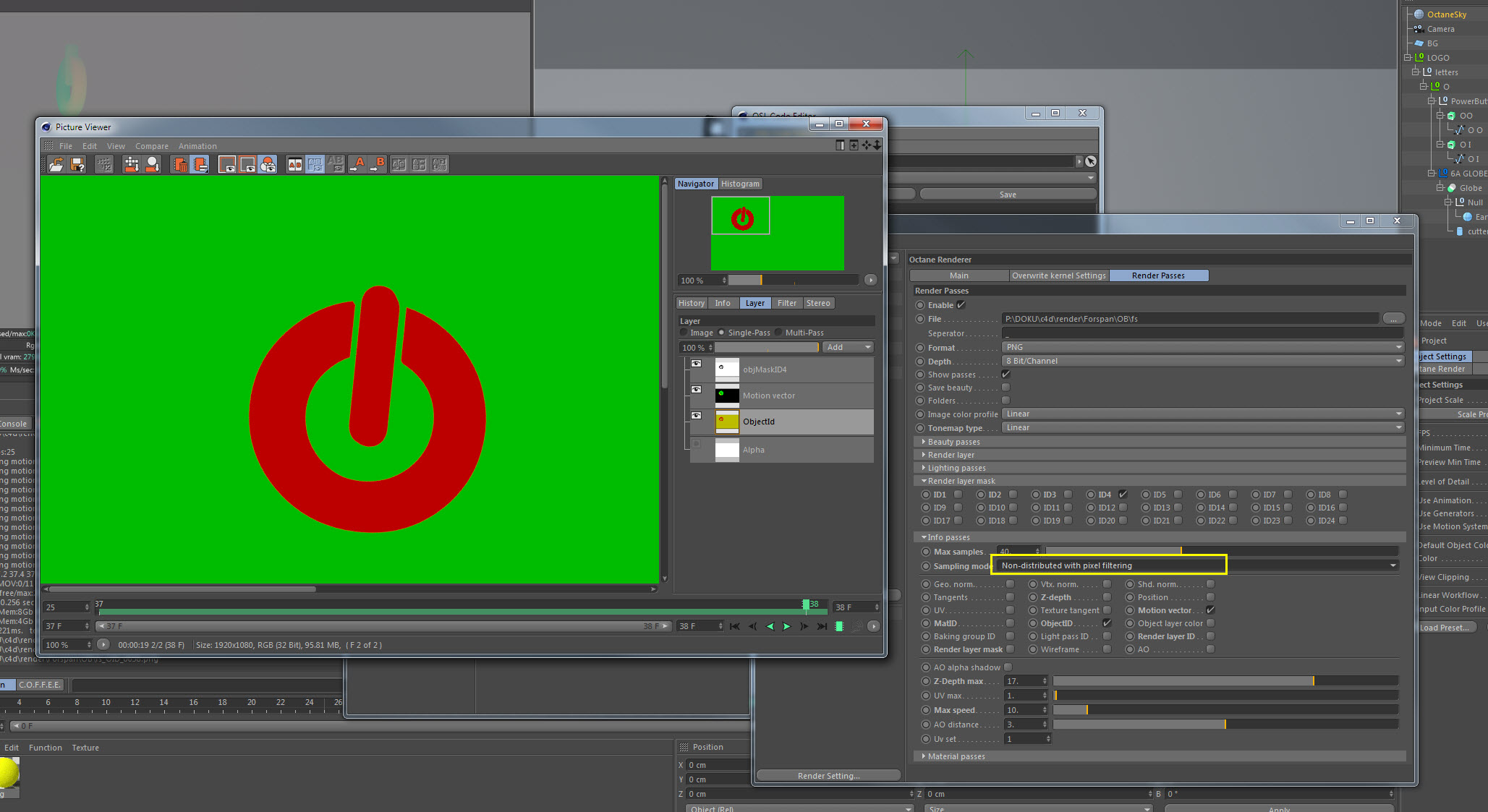

Other than this about mask + blur effect in "Render Layer Mask", you should do as in picture. I'll remove this topic from BUG section.

aoktar wrote:There's not any bugs, that's logic of how numbering works on ObjectID. They are produced by order of appearance to octane geometry structure. Here some objects are disappearing at frame 38/39 so automatised color assign is changing. You should use Render Layer ID pass from Info passes not objectID pass.
lol, THE most important part of this entire answer is in the image and the highlighted 'Non-distributed without pixel filtering which you don't even mention!
This option is the only way to have the layer masks rendered out free of motion blur. The amount of Octane jobs I've done where the compositor receives a beauty pass, free of camera rendered motion blur, a Motion Vector pass BUT along with this he receives all the IDs are with the blur rendered into the sequences all because the sampling mode was set to the default Distributed rays. HOW on earth is that ever going to be useful?? The sampling mode should be an automatic change and across all passes whenever motion vectors are rendered out. Pure and simple Octane!
