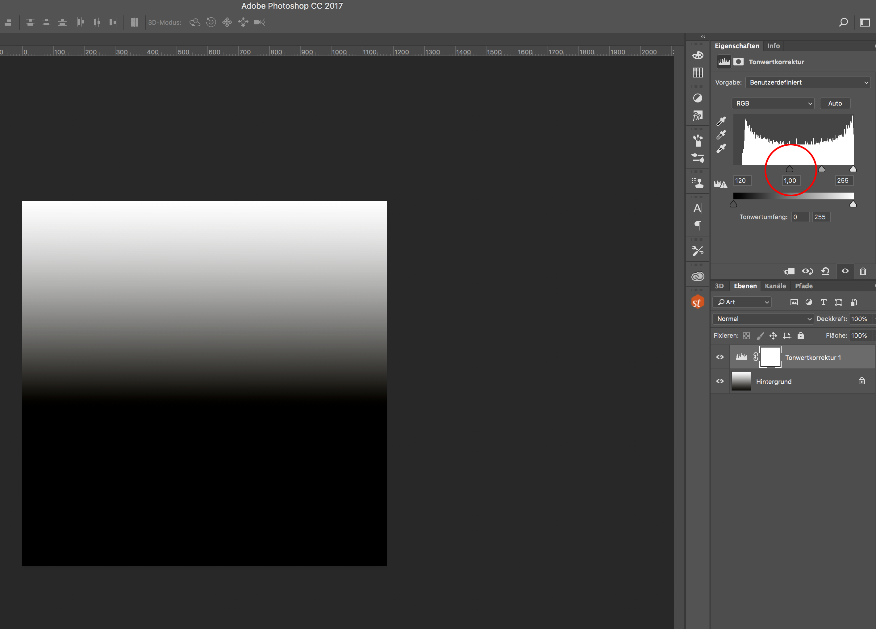

Hey there,
does anyone know a way to clip the blacks or the whites of an image? I would like to achieve the "opposite" of the clamp node. Just like the Levels in Photoshop. Maybe there is a way to build this effect with other nodes.
Thanks in Advance!

Hesekiel2517
Posts: 467
Joined: Mon Nov 23, 2015 10:57 pm
Thanks for your answer. I want to have this control and i also would like to animate it. So it would be great if there was a combination of nodes where i can change a single value to get this effect.

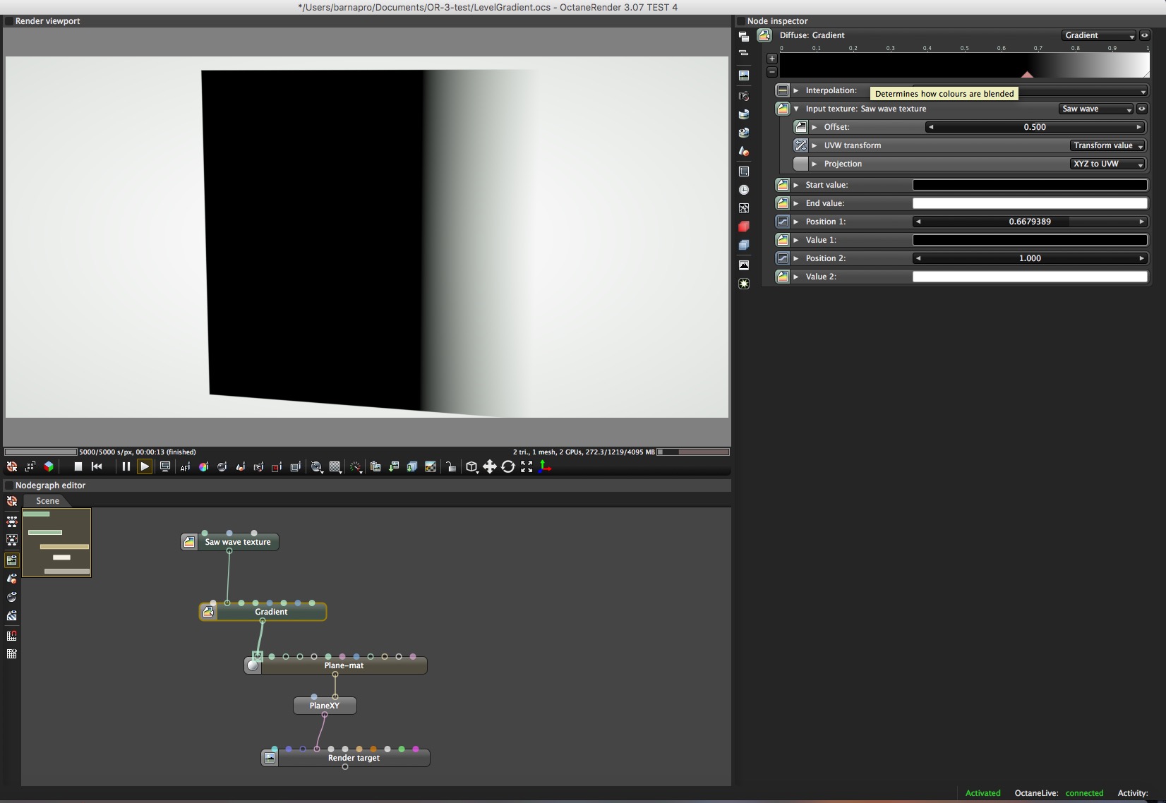

Posts: 10621
Hi Hesekiel2517,
vary basic example, but if you move the black or white point of a Gradient node, you should have a similar effect:
LevelGradient.orbx
(52.65 KiB) Downloaded 189 times

Hesekiel2517
Posts: 467
Thank you! This is exactly what i was looking for!
