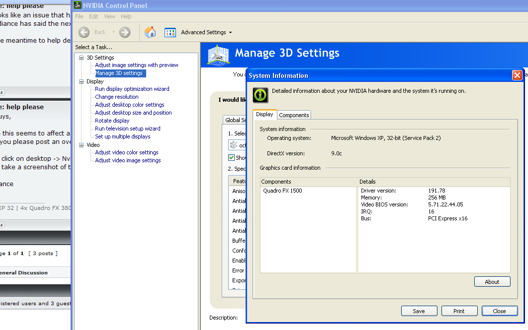

HI guys,
Yeah this seems to affect a handfull of people.
Can you please post an overview of your installed drivers ?
right click on desktop -> Nvidia control panel -> Help -> System information
then take a screenshot of the tab with all the driver versions installed...

I am sorry to tell you that the Quadro FX1500 isnt a Cuba capable card.
It is based on the Geforce 7900.
You will need a later card.
Have look at the list in GPU/Video forum for Cuda enabled cards - the slower and less suitable cards for Octane are noted there too.
