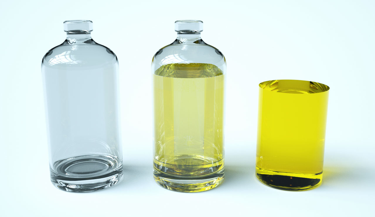

So, I choose to start making a bottle with liquid inside :lol:
First problem with the refraction. I've tried to resolve the problem alone but I can't figure it out. I have weird refraction from the glass.
> index at 1.5
> the liquid is intersecting with the bottle
> scale is almost "physically" accurate
> pathtracing
> hdri on
> tried various thickness, nothing change
> tried with specular material for the liquid, nothing change
> on the right of the screen, the index is at 1. It's closer to what I imagine/want for the liquid but not real and I lose all the glass refraction... So that's a nope.
Maybe something with the uv ?
I have no clue of what's going on :? Maybe I'm missing something huge ?
Can you help me a little please ?

I make a bottle and the liquid inside. I add specular material to both (1.5 for glass, 1.33 to liquid) and start rendering with HDRI and Pathtracing. This is what I got: see picture.
I was wondering if you have enough power with Pathtracing. Mine has Max Diffuse depth 8 and Max Glossy Depth 28. Maybe adjust the Ray epsilon value also.
Is your bottle subpatched or "frozen"?

I just adjusted the settings, 1.5 for glass and 1.33 for the liquid.
Samples at 2048.
Max Diffuse depth 32
Max Glossy Depth 96
And yet, the same problem. This weird little capsule style :shock:
But I know I certainly am doing something wrong.
Maybe something wrong with my modelling technic in c4d. I'm using a revolution nurb...
Oh, and I m using the transmission channel to set the color for the liquid material, and I think that's not good !
I keep searching :)
See the picture :mrgreen:

Try modeling with just extruded disc and no subpatching or nurbs.
Transmission is the right place to add color I think.

Ok, so, it seems to me that modeling from a disc did it !
So, to make it clear and understand the problem that I was having : the bottle was "empty" and now, it's "full" ?
In many tutorial I found on youtube/internet, guys are modeling in splines + nurbs directly in C4D or importing the splines from Illustrator.
Was I having a double refraction ?
Because My bottle wasn't "full" ?
asyto
Posts: 5
Joined: Sun Sep 03, 2017 2:59 pm
Ok, I think it was the modeling technique !
I gave my glass some thickness and made an "empty" bottle and it's working...
I'm curious about others modeling techniques to create bottle with liquids inside ? Guys ?
Thanks Builtdown :D ;)

I have a different workflow, but I can share the following from experience:
- leave a narrow gap (of "air") between the bottle and the liquid. the topology shouldn't coincide or intersect.
- in Octane, select your mesh node and in its import settings (the little wrench icon) uncheck "Load vertex normals". You can also try the "Merge unwelded vertices" option on/off, see if there's any change (but I doubt that).
- in the import settings of your mesh (again), try different unit lengths (at the top of the dialoguie "Length unit: < select from drop-down>")
Hope that helps. Cheers!

On the earlier shots your normals are look like they are the wrong way so the glass and liquid think they are inside out. The differnet modelling method seems to have produced correct normals
moose69
Posts: 38
Joined: Sun Jan 17, 2016 10:10 pm
If you are modelling from a revolved nurb you can just reverse the spline direction and the surfaces created will reverse the normals. If you make editable and have a mesh rather than a parametric object you can reverse the normals post.
