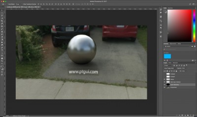

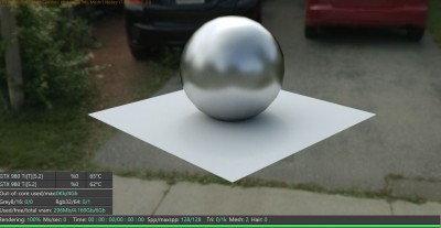

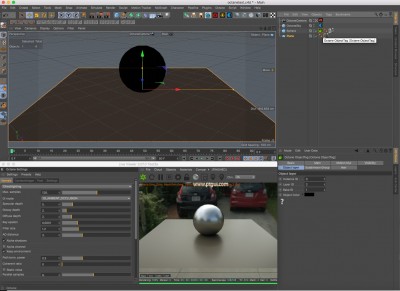

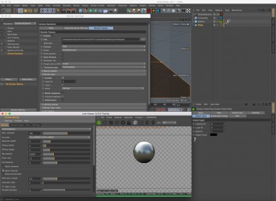

I have roughly corrected your scene: First of all, use the object tag with Object Layer ID 2 onto the Sphere, this is your primary object and the center of your interest. Note that by default all the other geometry objects are on Layer 1. Then use a glossy material with a color similar at what is surrounding on a bigger plane: Then enable the Environment pass in Beauty passes, and the Black shadow and reflection pass in the Render Layer passes, finally turns on the Alpha channel in kernel: Then in Photoshop, you need only to move the Environment pass at the bottom, and change the Reflection pass to Linear Add: ciao beppe
