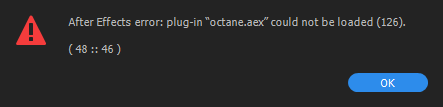

I copied the After Effects Octane files from "Support Files" in the zip file to "Program Files\Adobe\Adobe After Effects CC 2017\Support Files" (so the files in "Plug-ins" are in "Plug-ins" and the files in the parent folder are in "Support Files".
I then created a solid and applied the Octane Render effect to that solid. All I seem to get is this error:
Nothing else loads at all and if I try and add the effect a second time it says "invalid filter".
Is there something I'm doing wrong or is this a bug?

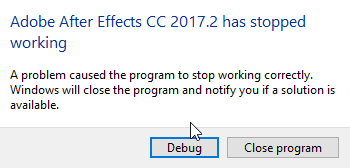

I just realised that I also had an octane.aex file inside a rar file called "octane". I extracted that to "Program Files\Adobe\Adobe After Effects CC 2017\Support Files\Plug-ins\Octane" which replaced the one that was already in there.
After this I tried again but this time I was prompted for a UserId and Password. After entering my Username and Password After Effects crashed with no error, just this:
Thanks.

Could you replace octane dir with this content and try again?
Octane.rar
(1.67 MiB) Downloaded 490 times
noisyboyuk
Posts: 103
Joined: Thu Apr 21, 2016 5:28 am
aoktar wrote:Could you replace octane dir with this content and try again?
Awesome! That seemed to move me forward - now it says I need a license so I assume that's fixed the crashing. Is there a place I can purchase a license for After Effects? I couldn't see it in the Shop.
