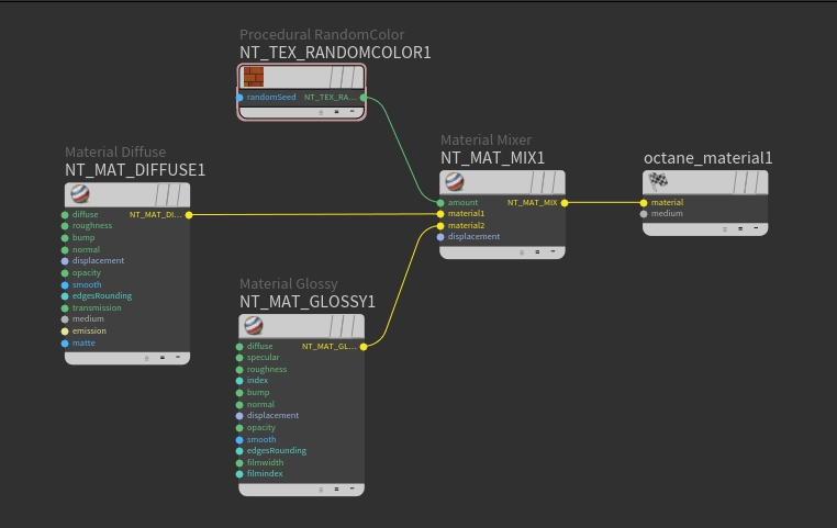

I'm afraid that currently this is not possible in Octane. The instances materials can't be overridden. You are going to need to have several copies of the same object, each one with one material, and instance them randomly.
At shading level, you have the Random Color VOP, that computes a random value for each instance. Perhaps with this node, you could build a shader with several materials mixed using the material mixer node. This node can also be used with the gradient node and others to render shader variations on each instance.
Hope this helps,
-Juanjo
Hope this helps,
-Juanjo
