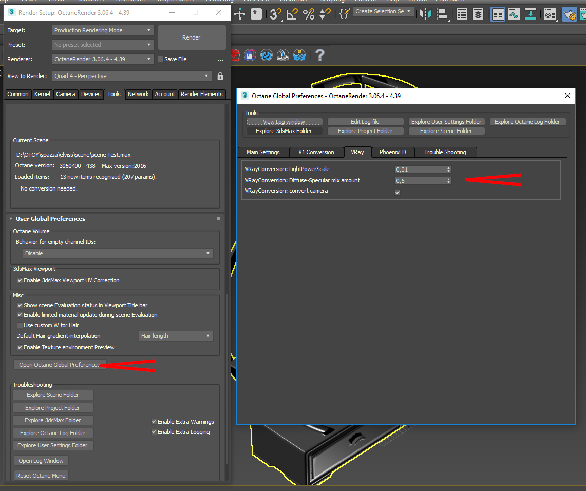

Hi SamuelAB,
Octane, currently, converts vrayIES light but not photometric IES Light.
The workflow I could recommend is using V-ray converter.
Select your photometric IES Lights then:
Right mouse click> V-ray converter
When all photometric IES Light convert to vrayIES light then use Octane Coverter:
Render Set> Tools> Material Converter> Convert All
Regards
Paride
