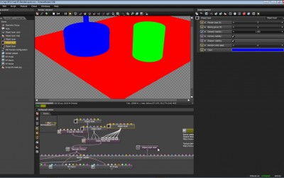

Hi nelsig,
you can specify your own id colors by using the Octane Layer node for single or multiple objects, and by rendering the Object Layer Color Infopass:
ciao beppe

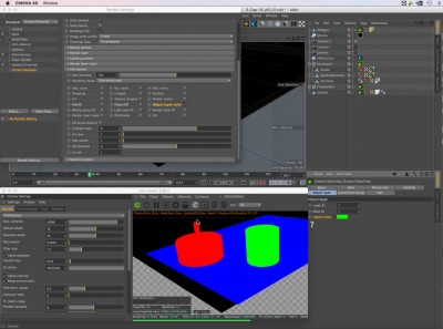

Thanks a lot ... sorry, I forgot to specify I'm using C4D to render, is there a way to do this in C4D directly ? or do I have to export my scene to the standalone ?
thx
Mac Pro Mid 2012 / Sierra / 32Gb / GTX 980 / GTX 780 / GTX 660 TI
Posts: 10579
Hi nelsig,
yes sure, you can use an Octane object tag to a an object or a group, and set the Object color in the Object layer tab:
ciao beppe
