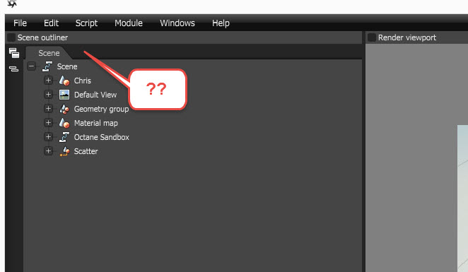

LiveDB tab not visible for me...? Nor LocalDB.
SU 2017, latest build.
Posts: 10633
Hi Seekerfinder,
weird, the panels should be there:
Anyway, you should be able to recall the panels trom the Window menu and place them in the right place.
