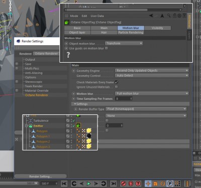

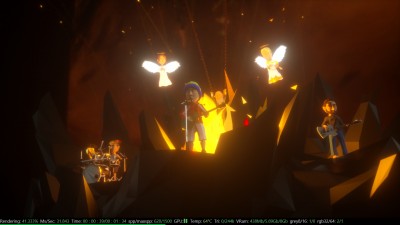

Hi there,
i´ve got again a little problem with motion blur ^^
If i use motion blur on the emitter it makes some strange pattern (those vertical/diagonal lines - first i thougt the chains are the culprit)
Alrdy tryed to crank up the time sampling per frames (to max. not just 8 as shown in the image) but doesn´t helps
motion blur.rar
(653.46 KiB) Downloaded 126 times

nobody an idea?! =/
tryed every possible setting but doesn´t matter - i´ve always get those nasty lines -_-
the only time they disappear are in the live viewer if i let the timeline run along - but in the final rendering they are there in every single frame

You may try guids on object tag and caching of particles before renderring.

Guids i´ve alrdy tryied but caching the particles does the trick!
Many thx =) using the motion blur within octane gives me much smoother/cleaner results than within postwork
