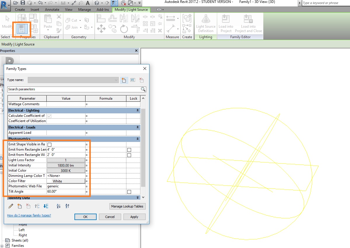

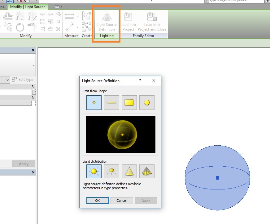

There is no geometry for lighting that is directly accessible to the user per say. Lighting surfaces are separate from all other Revit geometry. You can't paint it for example. You access it's form through a separate menu. I would not be able to assign the lighting geometry to a light fixture using the exact same geometry.
Perhaps this is a misunderstanding, because I am unable to envision your Revit to Octane lighting workflow. Perhaps a short video of the workflow would help elucidate this.
