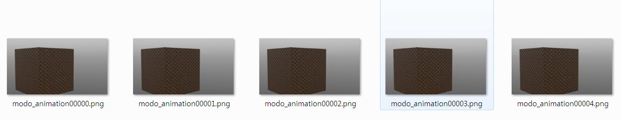

But when i render animations some frame after tweaking option from i made substance designer, Modo rendered perfect all frames what i intended, but Octane rendered only one image when i start a render frame during rendering all frames.

octane's results
octane's results

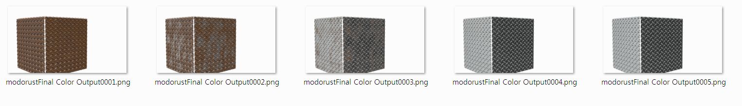

What i intended
What i intended

Hi - I see the problem you are having, and after some investigation it is still not obvious if this is a Substance problem or a plugin issue. I will need to investigate over the next couple of days, and will respond back here once I have more information. Sorry for the delay.

This is fixed in the next release of the plugin. I you need an urgent fix, I will post the pre-release of the next version of the plugin for you, otherwise you can wait of the next plugin release, which will hopefully be in the next couple of weeks.
