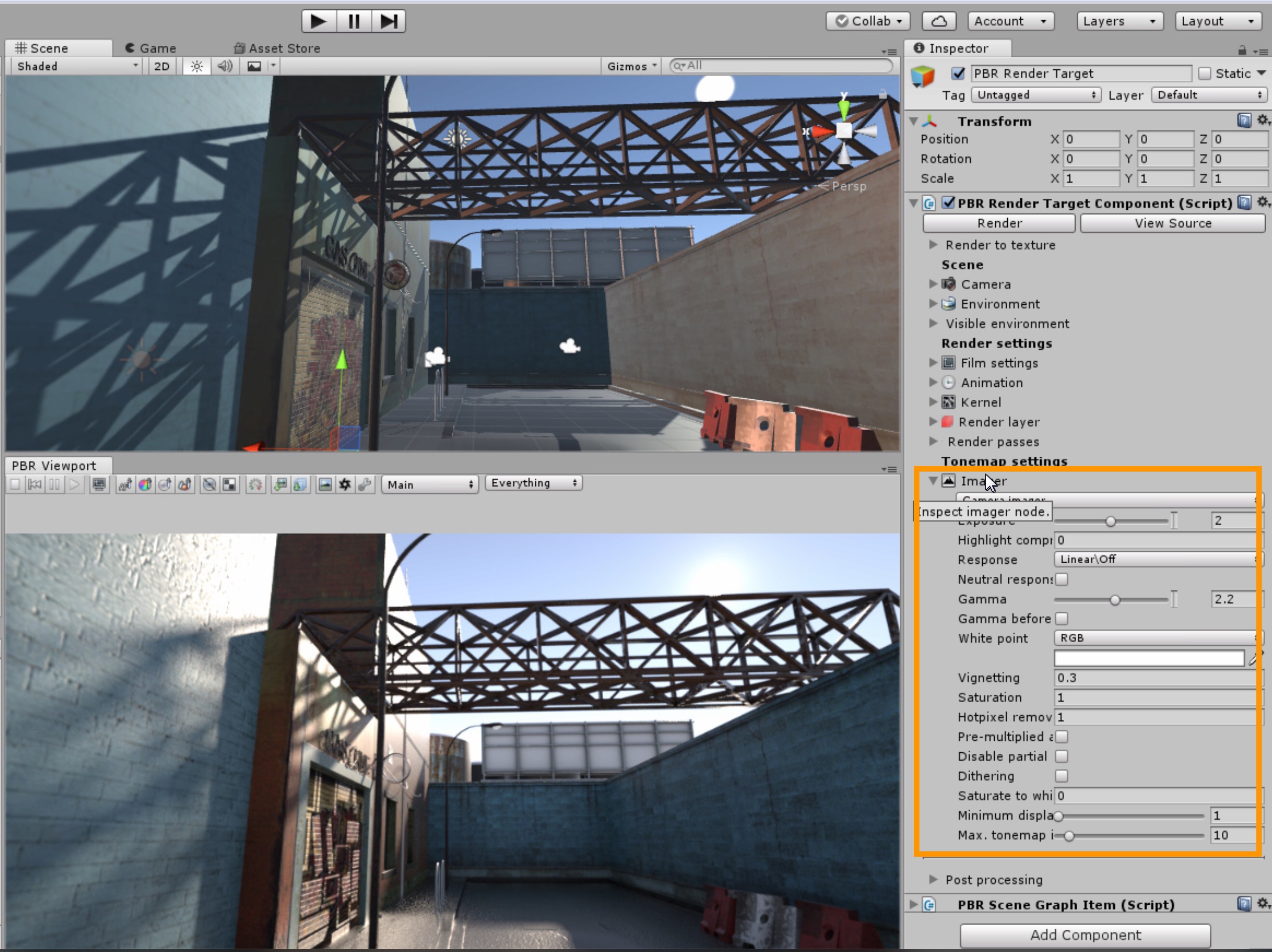

Hi Podden,
did you play with the Imager node in the PBR Render Target?
ciao beppe
Podden
Posts: 11
Joined: Thu Apr 07, 2016 11:29 pm
will try the Imager, thanks
