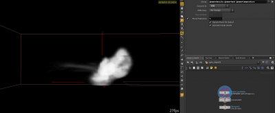

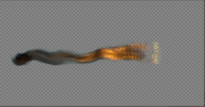

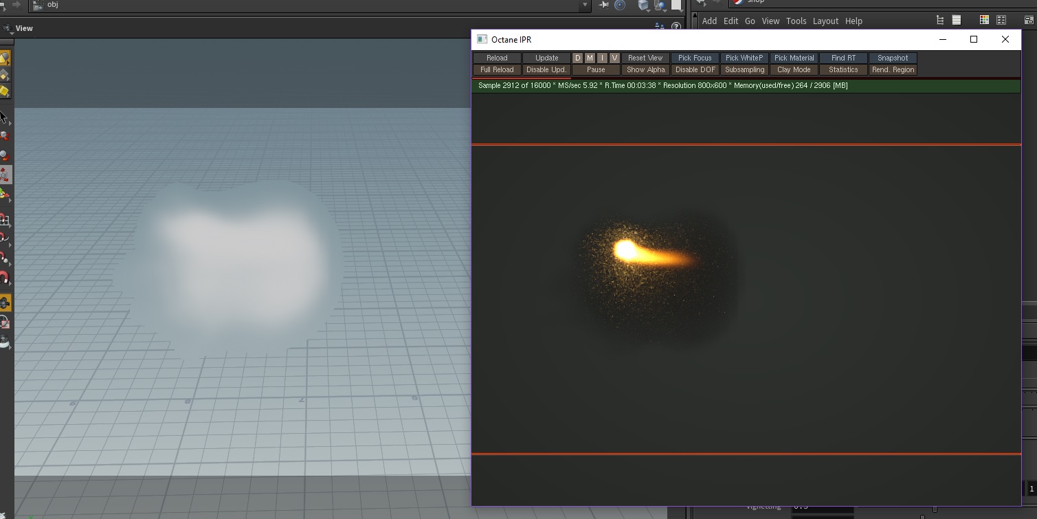

I have certain issues exporting volumetrics to octane. That's how they look in Houdini
, and at rendering in Octane
. Would be very grateful if someone hinted on what colud be the problem.

It is hard to say without the scene file, but anyway, you know that the plugin can render the Houdini Volume and VDB primitives directly without writing OpenVDB files, right?
https://docs.otoy.com/Houdini_Plugin_Ma ... s%7C_____8
What happens if you try to render this VDB directly, not using the OpenVDB file?

Hmm, I'm going to need also the scene that you are using to render the OpenVDB file with Octane. Here I can't see any problem with the exported file using a standard Octane scene and the Volume material HDA.
