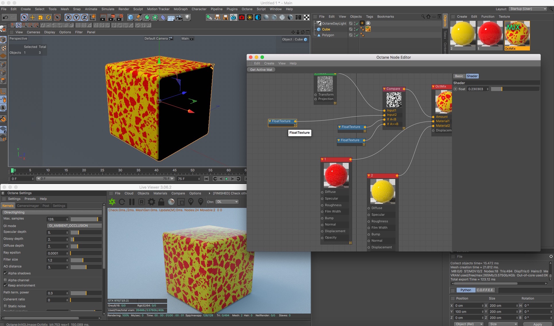

about Triplanar node, please, look at this fast example:
viewtopic.php?f=30&t=60947&p=311890&hil ... ar#p311890
about Comperison node, a possible use is for obtaining a mask from a texture when you really don't have it, look at this fast example:
changing the second value from 0 to 0.5 you can define where to mask the yellow color.
ciao beppe
