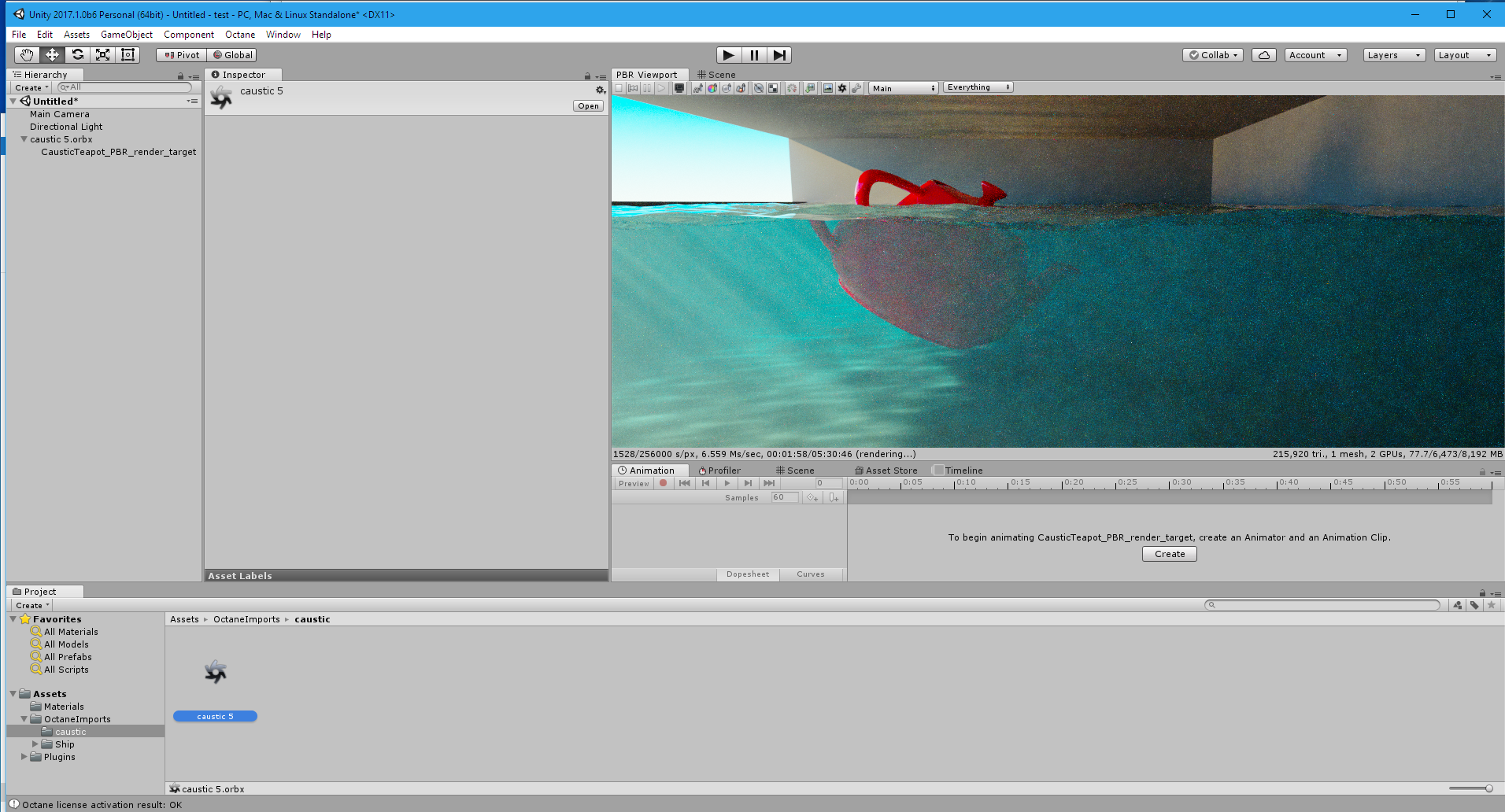

Then I tried to get the caustic example to work. I created a new scene and imported the unitypackage. It should be mentioned in the manual that you need to install Octane via the Unity menu first after creating a new scene before you can drag and drop an orbx file into the scene. Aside from that, when I drag and drop the caustics orbx scene into the Hierarchy, nothing happens and no error is shown. When I drag and drop the orbx scene into the Scene window, I get this error:
Restarted Unity and tried installing, and auto downloading again. This time downloading works. If forcing the user to download the latest version (which is the latest anyway), perhaps adding a timeout and retry would be helpful.
Anyway, after installing Octane in Unity, I added a cube to the scene, then loaded Octane. This time no error. Yay! Rendering works fine.

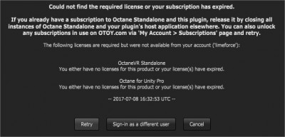

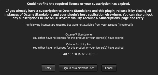

I own the Standalone and a Houdini Octane license. I have used ORC to do a simple test, but for some reason I still get the message "Could not find the required license" when I try to activate Octane within Unity. Would it be possible for me to join the testers, or should I just wait until the full release?
Thanks!
